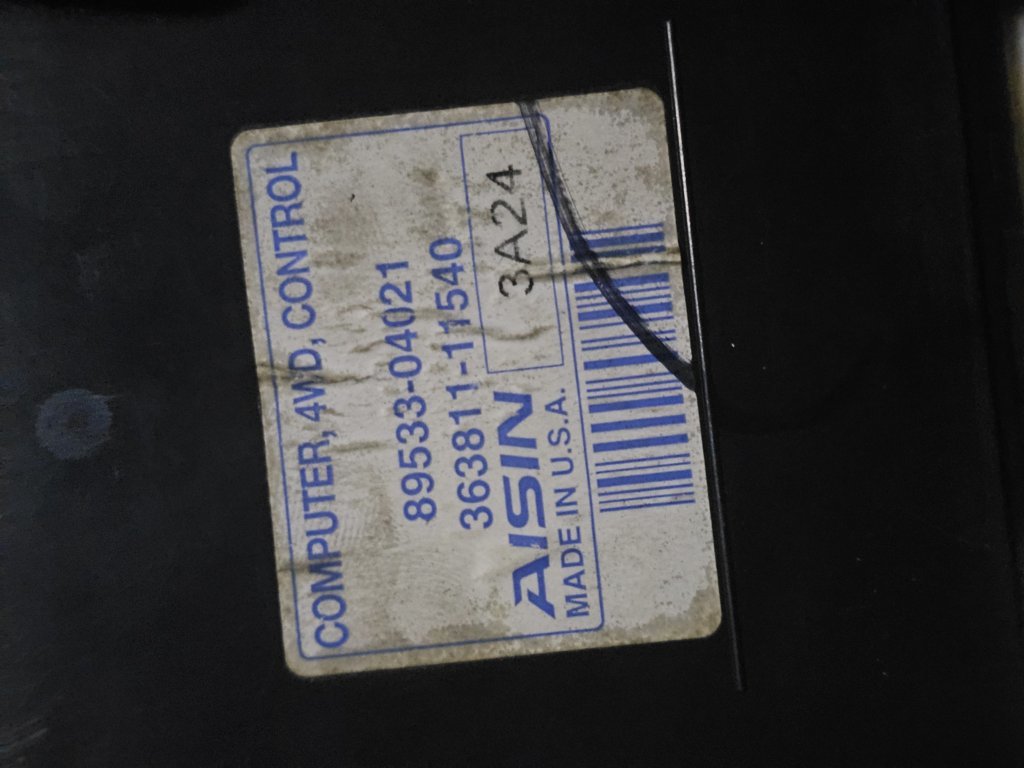

    The diff locker actuator is there and doesn't look beat up. The 4wd ecu number is 89533-04021 and the number right below that one is 363811-11540. 20250130_211849.jpg

    Yea that's the non locker ECU, the one with the locker should be 89533-04011

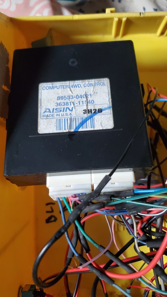

  11. Jan 30, 2025 at 7:36 PM

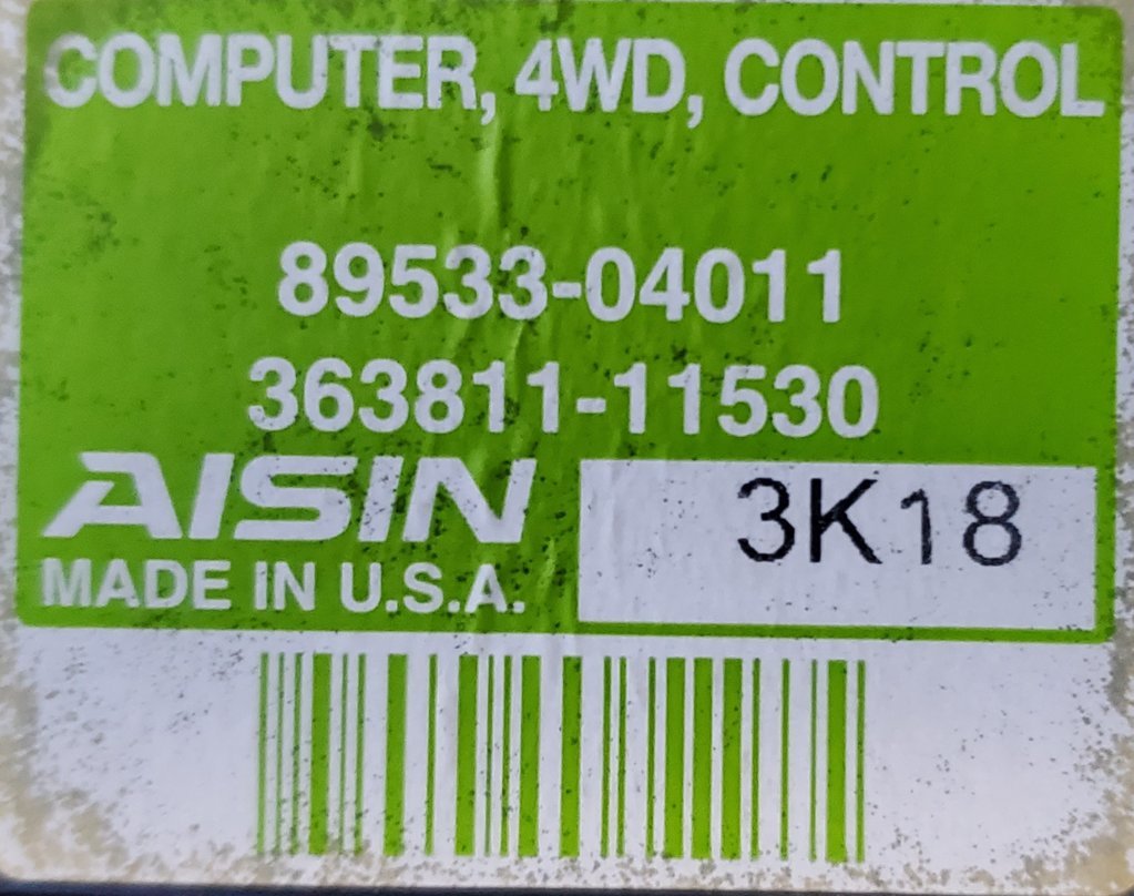

  12. Jan 30, 2025 at 7:47 PM

    If anyone is selling the 4wd ecu 89533-04011 please message me
