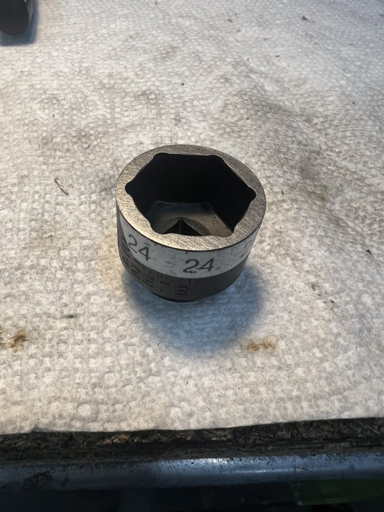

    I have a 24mm 6 point socket with the taper ground off for shallow bolts like the fill plug. That allows deeper engagement and less chance of rounding the bolt. An impact wrench is also worth a try. At least on the front diff it pops right off with impact (like literally less than 0.5 seconds). I haven't needed to use it on the rear.

    I do this to wheel bearing sockets too.

    You will need a short socket eventually for the transmission fill plug, to fit in the confines of the transmission tunnel.
