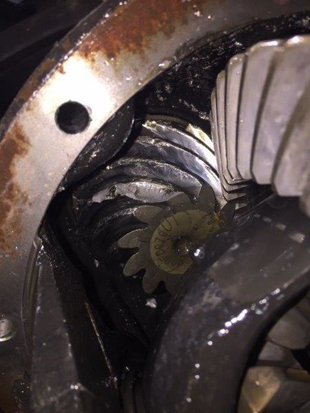

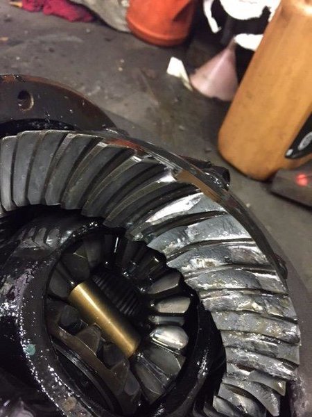

    In the top photo note the marks on the carrier under the ring gear. Then note the scuff on the end of the pinion gear. I suspect a bearing failure on the pinion or a crush sleeve failure. Pinion moves in and crashes into carrier and bang. Only other time i've seen this was on a manual transmission and caused by excessive axle wrap but not on a toyota.
    Mush Mouse and Toyko Joe[QUOTED] like this.
