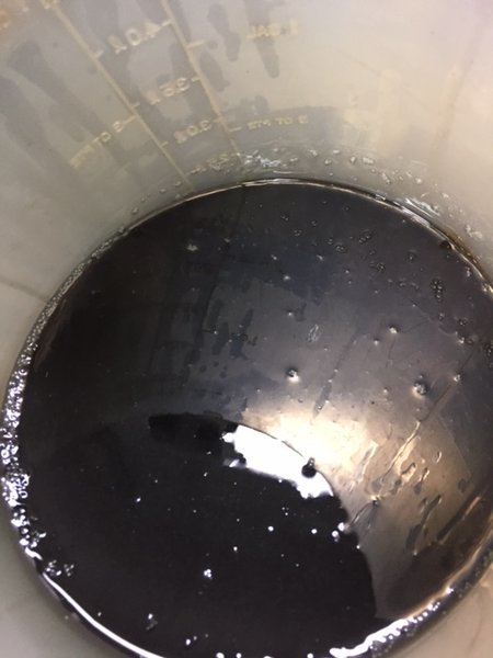

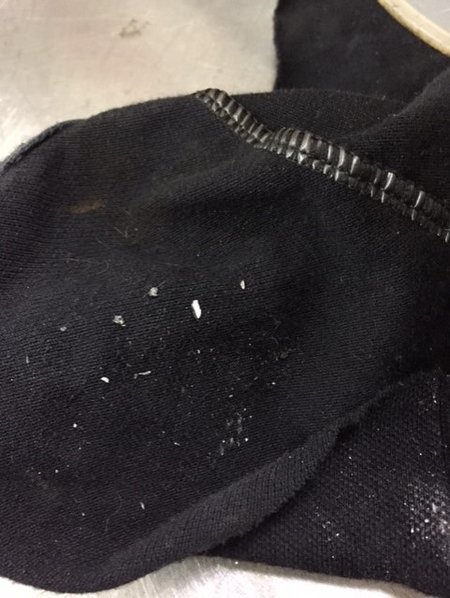

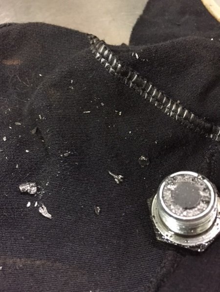

    If that happened to me, the offer I mean, I would take it in a SECOND! My truck was absolutely quiet for the first 25000 kilometers and then it was catastrophic failure. It was definitely the dreaded howl at 50ish mph when I got it back but honestly I was embarrassed to even bring it in as they ultimately made me feel like it was my fault it had happened and I thought they would just shrug it off and say "road noise" or "tire noise" like others have said they were told when complaining about the howl. It got to the point that I couldn't have a conversation with passengers in the back seat so I reluctantly made an appointment. 2 hours later they came and said it needs a new differential. The case was full of fillings and "chunks the size of a thumb nail" as per the tech's explanation. Of course then I had to spend another 4 hours arguing with Toyota Canada to give me a loaner only to be told at multiple levels that I didn't have extended warranty and that because I got a loaner last time it would be unfair to the people that pay for extended warranty that I would get something for free that they paid for. Keep in mind that this truck now has 29000 or so kilometers so well within the original warranty. My math on the kilometers is slightly off as I didn't record it this morning and they won't let me drive truck. Basically it had between 25000 and 26000 on it when it blew up the first time and it's around 29000 now. I can update when I get a printout and compare to the last printout in February. I've also enclosed some more pics from THIS time of the filings in the case / oil.
    I did get a loaner but as I understand it was completely and independently provided by the dealership. So that the dealer stepped up I'm actually quite pleased as I cannot be without a vehicle as I'm in sales and need to be mobile.
