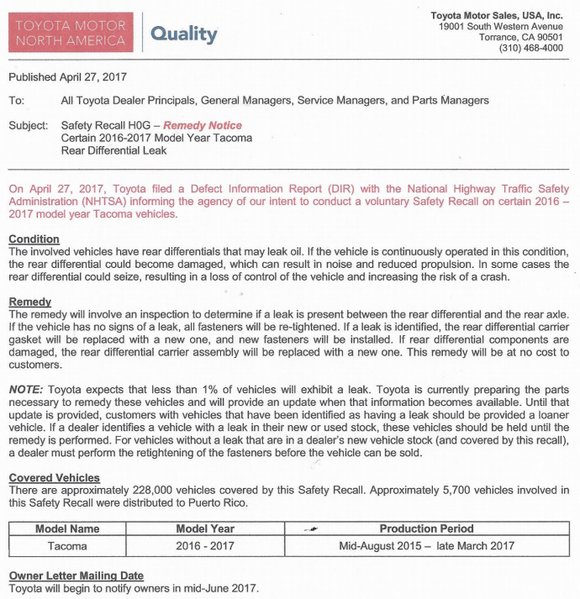

    So, if I read this right, the underlying problem is that bolts might have been undertorqued, thus causing leakage?
  2. May 24, 2017 at 7:32 AM
    #382
    2016LimitedTaco
    2016LimitedTaco [OP] Well-Known Member
    Feb 20, 2017
    #211084
    46
    Derek
    2016 Tacoma Limited
    Rear heated seats, pop-n-lock tailgate, undercover flex tonneau and bed lights
    Yes and know. I think that's what they're saying but that is 100 percent NOT what happened to mine twice. I haven't had my truck for 4 weeks. No end in sight. Just want out of this bullshit.
