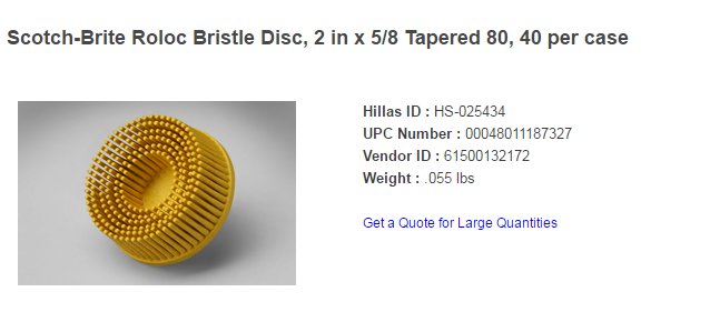

    I agree with this. Have seen it personally myself with these "mechanics". If possible @2016LimitedTaco , get the shop foreman to inspect the tech's work and get him to confirm the install and set the proper tolerances with the tech, which "should" be better than factory production tolerances. Hopefully they have enough experienced techs there to work on your truck. There are things that some techs don't do well and a warranty issue like this that can fail in a catastrophic way is a liability issue for all parties repairing the vehicle.
    I've worked next to techs who took a f@cking ROLOC bristle wheel to an aluminum cylinder block to clean head gasket residue when a razor blade would have sufficed and not actually remove material !! This is after the head got sent out and decked for warpage due to an overheating issue. This was at a dealer I worked at. It's scary what kinda nonsense gets passed. Hopefully your diff issues get resolved properly.
    This is a ROLOC wheel for air angle grinder for those who don't know what I'm talking about. This left depressions and gouges in the "supposedly" super flat aluminum surface the cylinder head should be for the gasket to seat and load properly.
