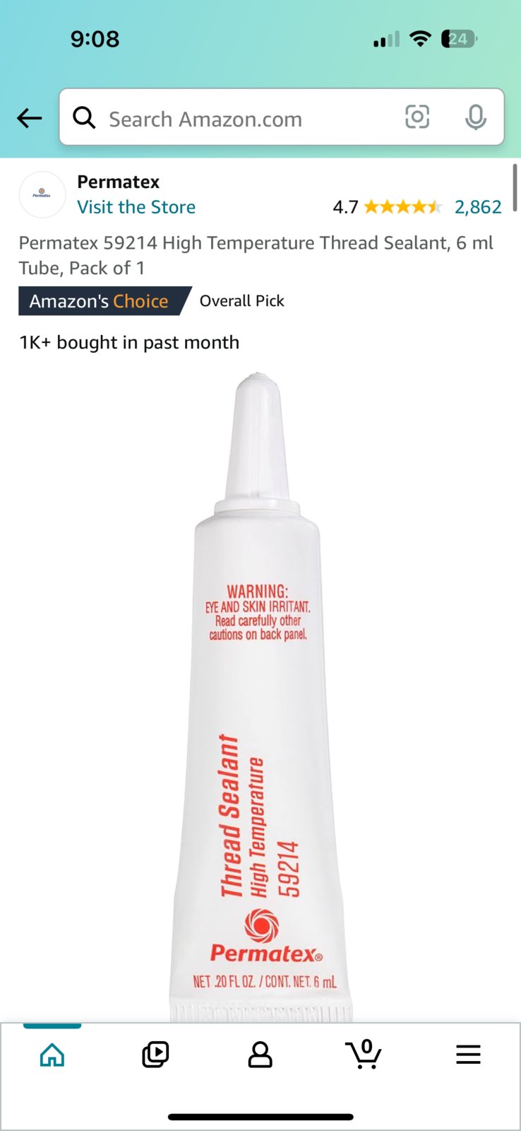

  6. Jun 19, 2024 at 6:06 PM
    Josephray70
    Josephray70 Well-Known Member
    Jun 1, 2024
    #450775
    609
    Joseph
    Grand Rapids, MI
    2017 Toyota Tacoma limited
    Bilstein 6112/5100 at 2” (6/8 circlip, 3/8” top spacer, sway bar drop bracket, YotaWerx Black Hawk 2.0 tune, Borla Pro XS exhaust, Freedom Off-Road UCA’s, Alphrex Luxx Series smoked taillights, Westin bull bar, 265/65r18 Cooper Rugged Trek tires, 18x9 Anthem Off-Road wheels -12 offset, 4.5 backspace. Rock Sliders that I fabricated.
    I would use thread seal.And a new crush washer. I did have this problem because The Allen stripped out and I welded a nut to it to break it loose. It leaked after that so I used this thread sealant and it worked. But I eventually replaced the plug with a new one from Toyota. Mine was the front differential though.

    Are you really running your Diffs that hot ??
