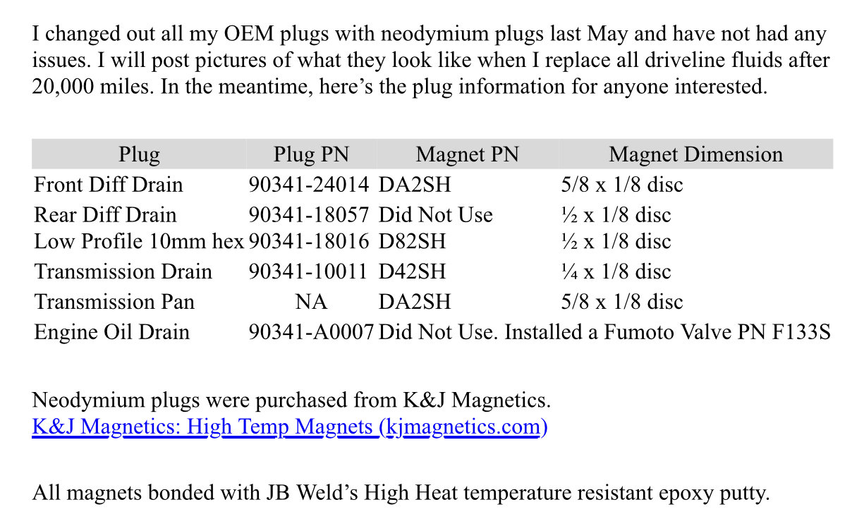

    That is awesome. Can you list out the diameters of the magnets that you used for the plugs you modified? I think I might try this on my next driveline oil service. Thanks

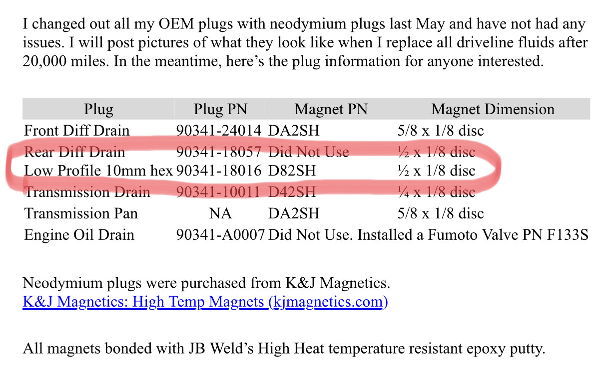

    I didn’t use the OEM rear differential plug but used the low profile plug circled in red instead.
