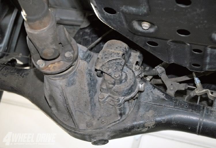

    The diff covers are not removable on Tacomas the only way to fix this is re-tap the hole. This is not hard just a pain the 3rd needs to be removed and the hole drilled and tapped if the metal is thick enough for it you should be good. if not you will have to drill and weld on a new drain hole I'm sure a diff shop and fab something up but it might cost you a few bills.
    You can always do this http://stores.hi-potek.com/-strse-63/Kit-for-modifying-steel/Detail.bok
    This is the only removable thing the 3rd member the cover on the other side is welded on.

    Thanks for the Reply Jlee. Let me get this right.. I remove the 3rd ( the part that runs between the drive shaft/axle and differential,) drill out the bolt, tap it and replace bolt. Am I going to have to remove the current strips threads till it is smooth, then retap, or can I just drill out bolt and retap? I guess I didn't really know what you were referring to by "if the metal is thick enough you should be good." Could you clarify this and like the tapping drilling process for me?

    Yeah where the threads are it should be a little tube that's tapped if its not thick enough to drill and tap you will have to replace it with somthing like the one in the link I posted.
