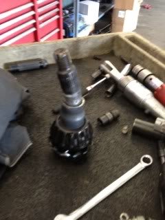

    i guess the internal locker got extremely hot and so did the drop out housing itself.

    Look's like its time for a new differential! Toyota can have a new one here in a day. Im ready to move forward, and get back to wheelin!

    Soy oil is not a substitute for gear oil :cool:
    Edit: it seems that you had not enough oil in there. I would replace axle seals just as the precaution. It would suck to put new thrid and loose it because axle seals had leaked oil.
