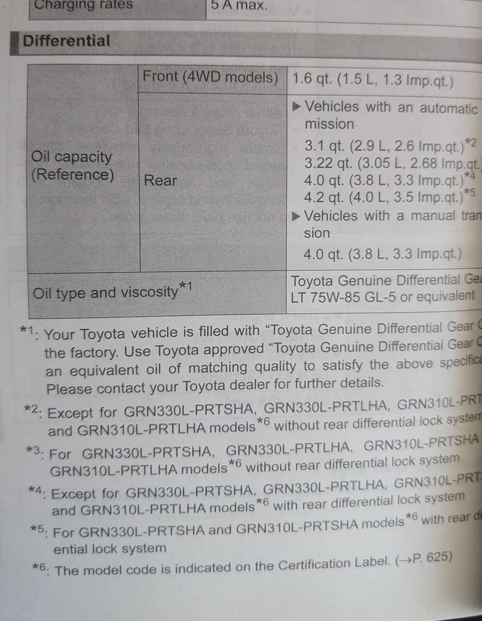

    As said earlier you must look at your white driver door sticker. It will tell you the model. Than go to the chart to see which one applies to you. I have a 2016 OR and my model # was the 305l so it uses the 4 qts. The chart in the owners manual can be confusing at first.

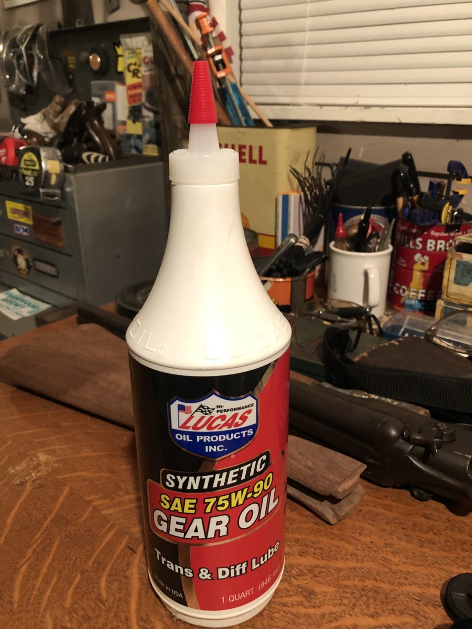

    I just replaced my rear Differential fluid. Im way late in doing so at 26k....i know, shame on me.
    There weren't a crazy amount of shavings on the magnetic plug, but the fluid reeked and it looked like metallic charcoal paint.
    Anyways, I drive a '17 TRD Sport, 2wd, Automatic.
    I used Lucas 75/90 synthetic.
    It took 4 quarts to fill. maybe a tad more or less.

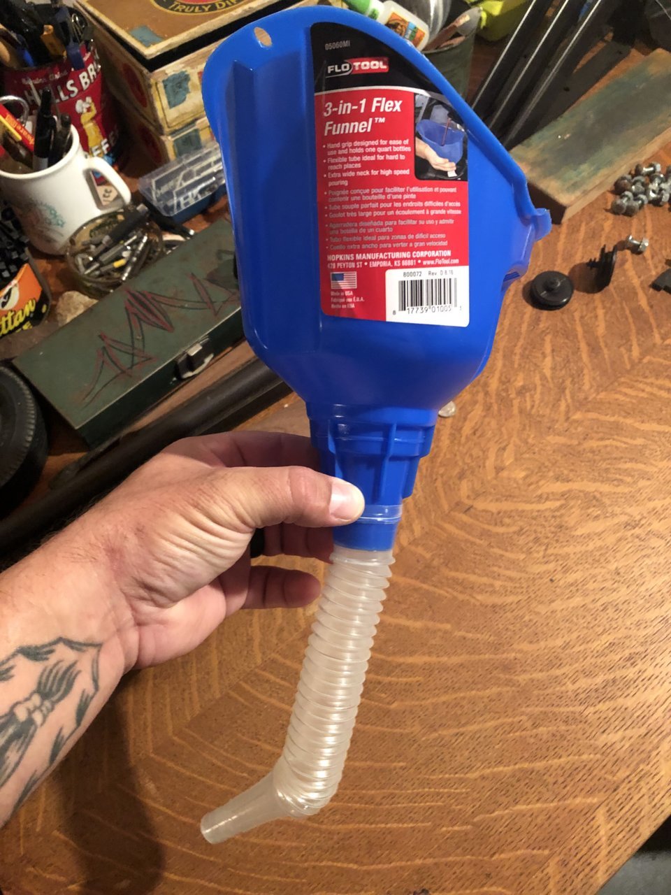

    I also used a funnel I bought for 5 bucks from O'Reilly auto parts that worked awesome when re-filling the rear end.
    You will need a 24mm socket. Large metric sizes aren't in everyones tool box, so thought I would mention that and save someone a headache.
    here's pics for anyone who might be doing this for the first time....do it at around 5k for the first time....don't wait until 26k like I did.

    Holy crap! I got the same model # GRN30L-PRTSHA and was still confused on with the manual. I was literally uploading a picture of it to ask for help. The only defaults I can see is the matching 305L part (3.22) but that's not what you have stated above. Then that model number is not located in any of the starred (*) exceptions listed. So confusing. I only put 3qts in ATM but going back to buy another bottle or two to top it off. I'm guessing from what most people do, they just fill till it spills which probably doesn't do any harm?

    That’s what I did, I filled it till it was coming out from the fill hole.
