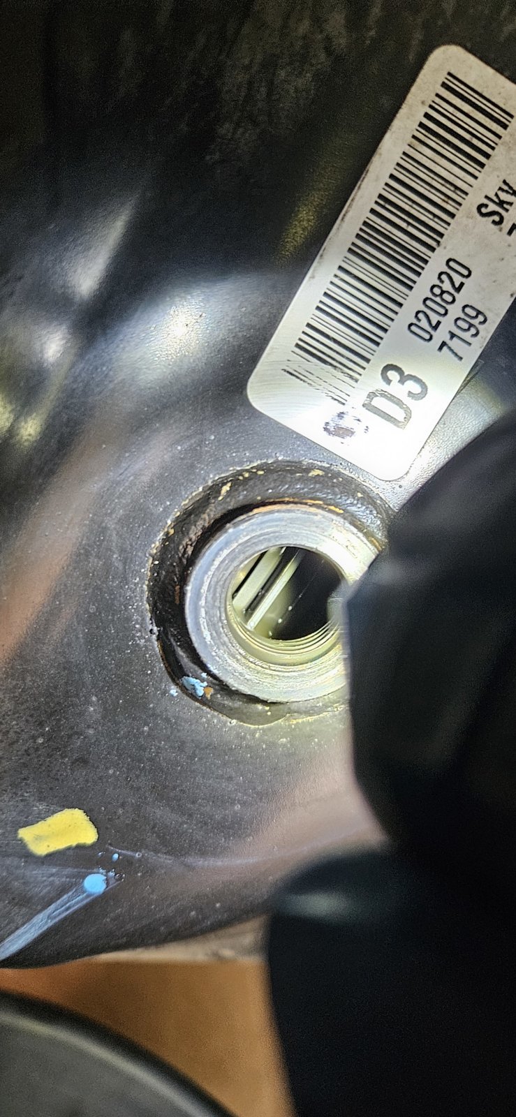

    Here's what my level looked like before the change. Extra room compared to OEM could definitely account for the extra fluid. I didn't even measure mine and just spilled/filled.
    Gibby656 likes this.
