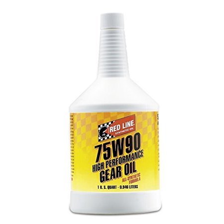

    I’m a huge fan of Redline, I use all of their oils. Full synthetic polyol Ester base stocks, not much is comparable except maybe Motul.
    You can get their gear oils for around $17, which I know is expensive for a lot of owners.
    https://www.summitracing.com/parts/...MIocrDuY7q4AIVVYezCh0QLw0OEAQYASABEgL8D_D_BwE
    The most affordable is Walmart Super Tech for less than $6.

    I don't know about Mobil One or Royal Purple or any of the other synthetic gear oils, but there is no mistaken for Redline, either new or used.
