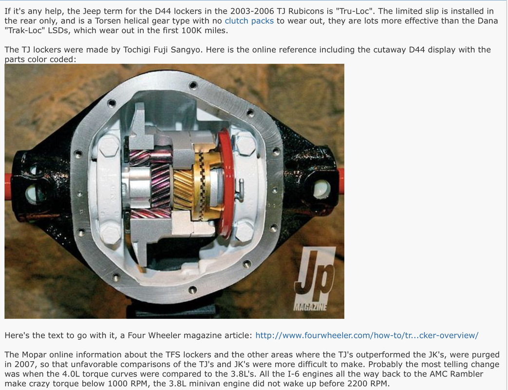

    Actually it is possible to have the LSD and a Locker in the same differential case. My 2005 Jeep Rubicon most certainly has a geared LSD and an air locker:
    Alas, Toyota did not provide such a thing for the Tacoma.

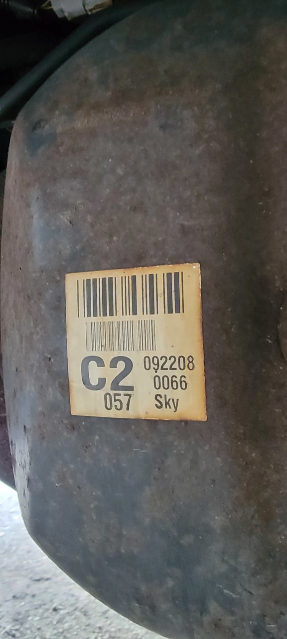

    I have this rear :20230420_065454(0).jpg
    Thoughts on the fluid or additive I should use? It's an 09 base model but has these:
