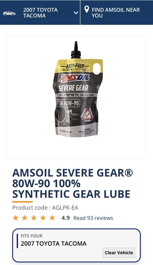

    Planning on changing the rear differential oil on my tacoma 2007, automatic, 2.7 4cyl, 4x2.
    Any inputs on this amsoil oil? Also, is this de correct oil grade?

    AMSOIL is great gear oil. Factory spec is 75W-85 but not many companies make it; instead most companies make a 75W-90 including AMSOIL. 75W-90 matches OEM spec closer by the numbers but 80W-90 isn't going to hurt anything. All things equal I'd just go with the 75W-90. Been running same fluid in my front, rear, and t-case for many tens of thousands of miles. Blackstone oil analysis tests also show it's good stuff.

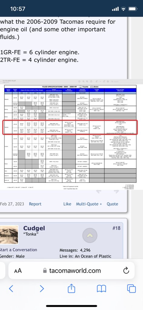

    I was a bit confused about the oil grade. I did a research because some places suggest 75-90 and others 80-90 for differential.
    Found this info:
