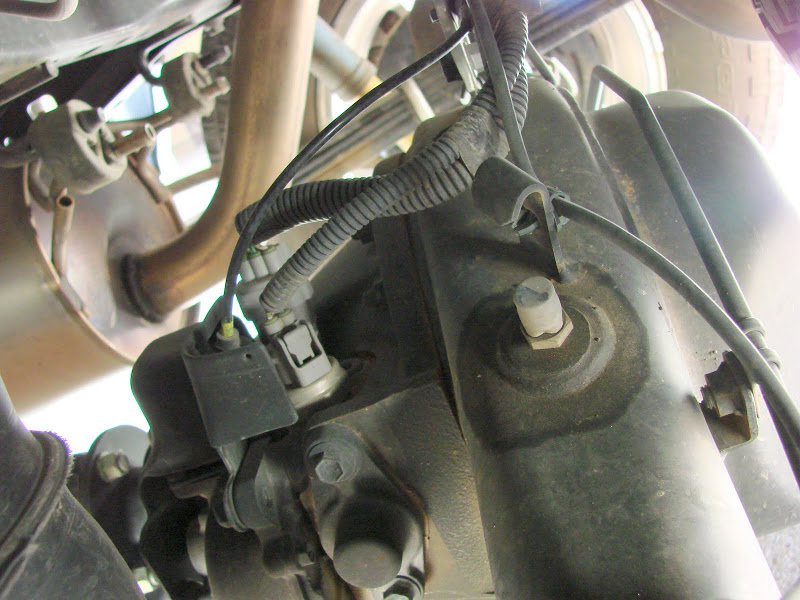

    Entirely possible. If the air trapped in the diff became hot it would expand creating pressure, and you relieved the pressure when you open the fill plug. That said, the air should not be trapped in the diff.
    In the photo below, the stem sticking out of the axle housing is supposed to allow the diff to breathe. You can see where mine spit up some diff oil, probably when off roading on bumpy roads in the desert.
    Maybe yours got plugged up? :notsure:

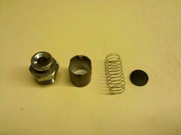

    So I pulled the breather out today and the same thing happened. The rear different is under a vacuum.
    So I pulled the cap off the breather and found this.
    It's a check valve.
