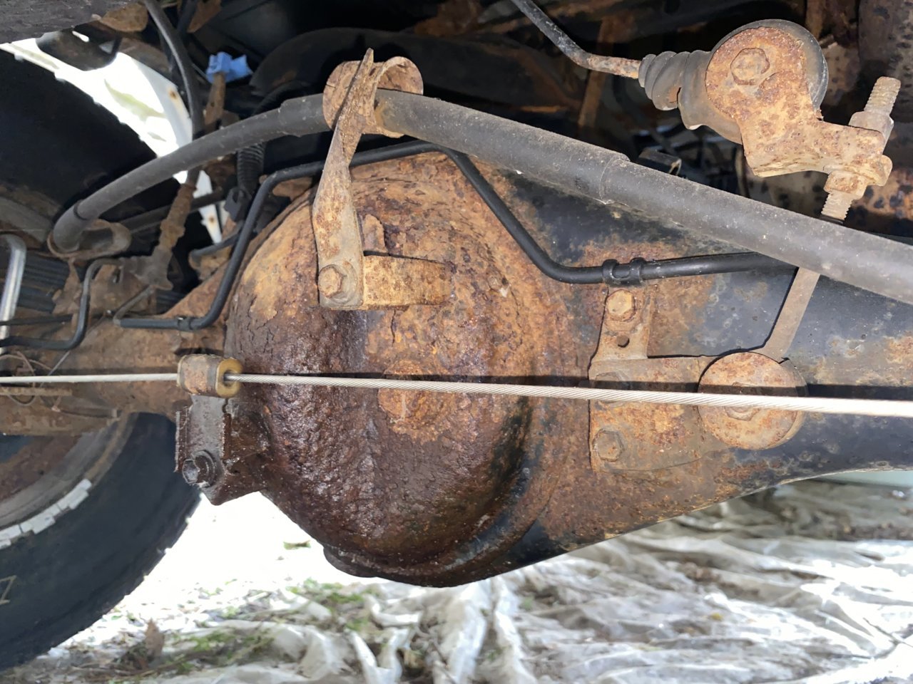

    Had my truck parked up for roughly a year drove it about say 2-3 weeks ago didn’t notice anything drove it again today and noticed a rear differential leak does anyone know what might’ve caused this

    @Dm93 @Cucvfan looks like the leak is coming somewhere from the center not sure what that part is called the area where you fill and drain it I will get an image and post it to give you guys a better idea what might be going on

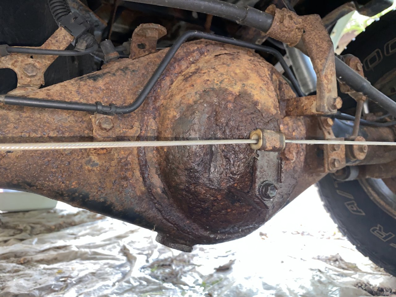

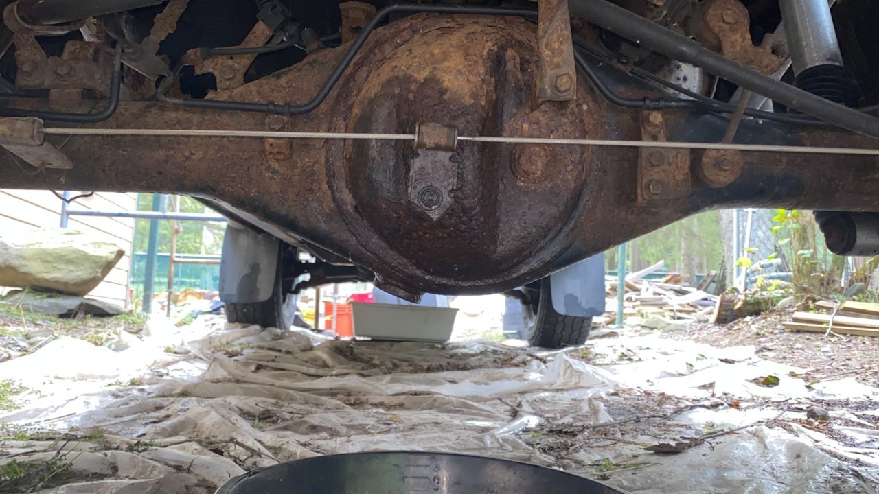

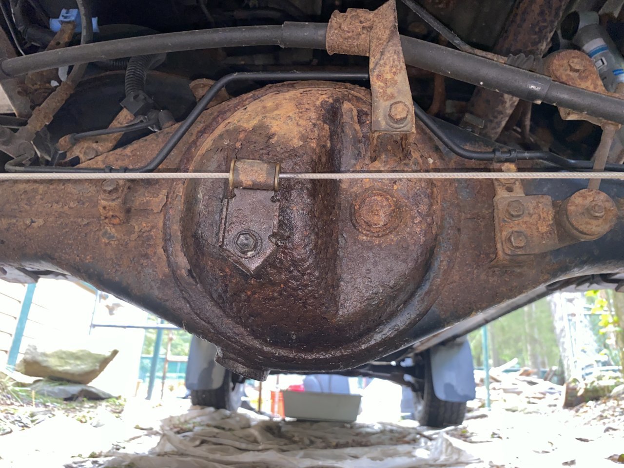

    My guess is it’s leaking through all that rust,
    I had a Tahoe were the diff cover was rusted through and the oil was leaking out.
    Looks like a similar issue,
    Tahoe i just replace the diff cover that’s bolted on,
    Tacoma diff cover looks more complicated to replace.
    A complete axle replacement might be needed because SOO MUCH rust on the axle also and cheaper if it’s not a locker if you can do it yourself
    your diff cover looks completely rusted out and shot to me and the rest of that axle is not far behind from rusting out.

    Yeah, looks like ypu need to have the diff xrained, and the pumpkin cover removed, then resealed and filled back up. May even need a new cover.

    Get yourself a new diff cover: https://www.dormanproducts.com/p-105095-926-993.aspx and find an auto shop to drain the diff, cut the old one off, and weld the new one on. Then do something to handle the rust, otherwise, the frame is toast. If you had rust you were chipping off "years ago" then you missed an opportunity to take care of your truck.

    I had this done recently. Drained the diff, cut off the old cover and welded a new one on. After they fixed some of the welding issues, it doesn't leak at all.

    Some people being very careful have done the job with the differential still installed.
    controlling the heat .
    The ones I have done I strip the axle housing .
    I use a weld on female pipe fitting for the fill hole. the cover is to thin to tap.
    I have seen replacement weld on covers.
    I would not trust this job to a normal auto shop unless they focus on fabrication or you will be replacing the differential shortly.
