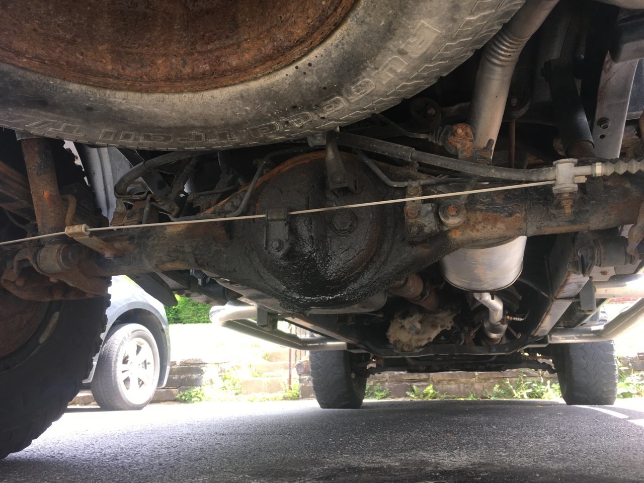

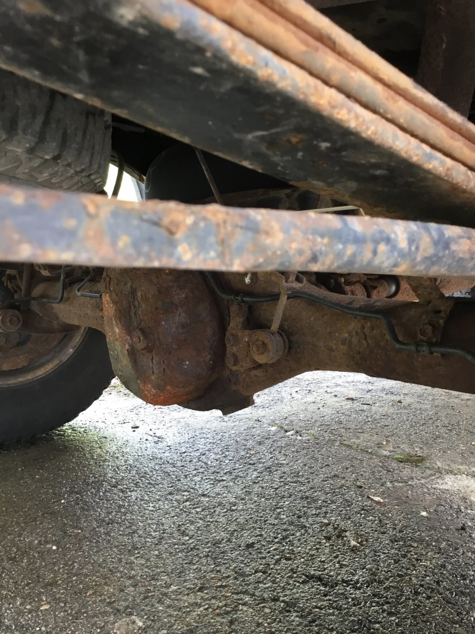

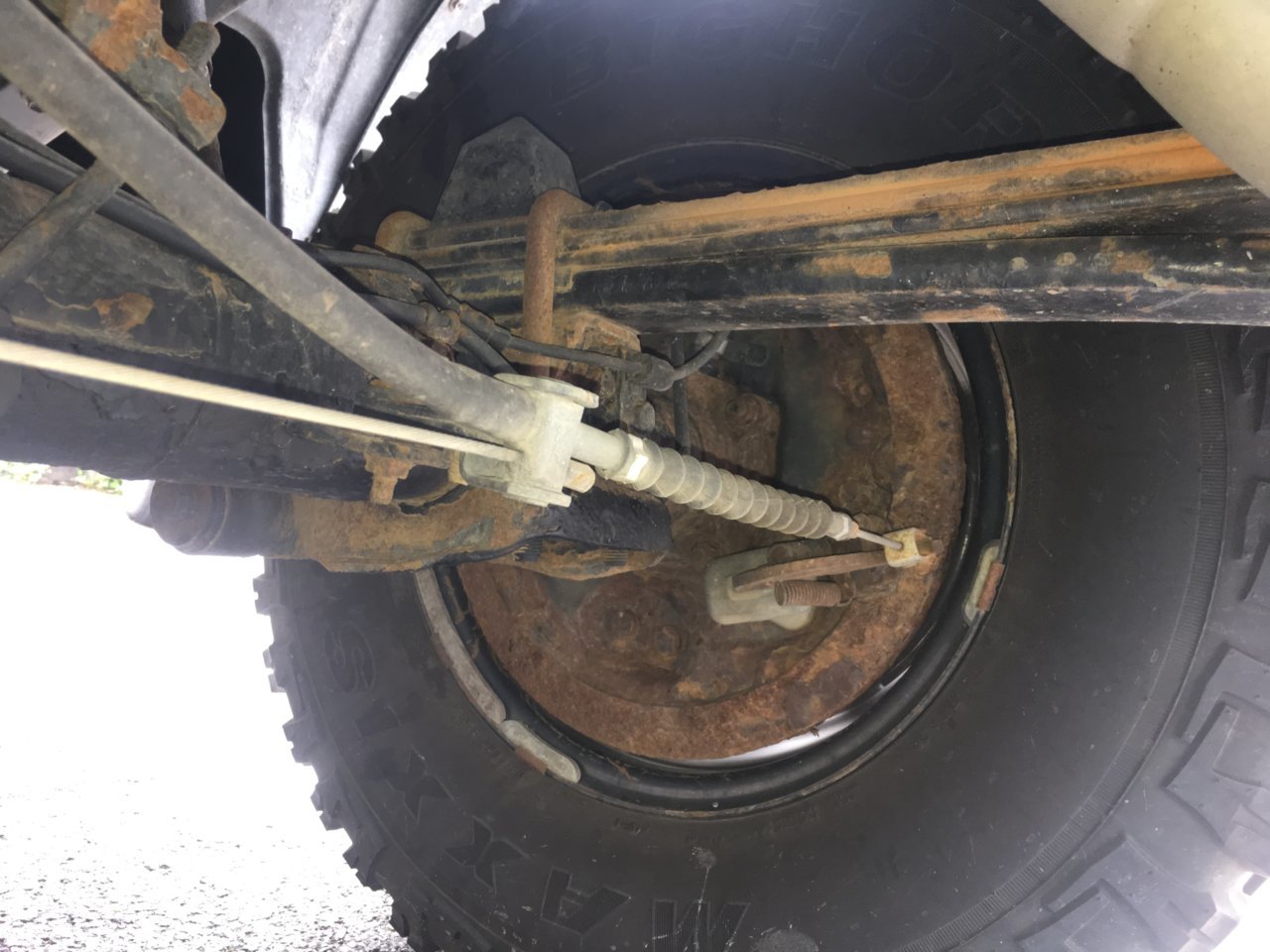

    Hello! So I have noticed and been told that my rear axle housing cover for the differential is rusting and starting to drip oil. I have a 2004 Tacoma 4x4 SR5 Off road 3.4V6. I am wondering if I should just get a new off road housing cover for the differential and have it welded on or find a new rear axle assembly, which seems to be impossible! I found out that I have the 4.10 gear ratio in it as well. I also found the Trail Gear Rock Assault Rear Axle housing for 95-04 tacoma and I am wondering if that would be better. Does anyone know what would be the best fix for this? How much work would go into the trail gear housing to make everything functional with the various cables and vent, etc.. I’ll attach some pictures as well. Thanks! Sorry for the long post.

    Could always JB weld it. Not the "best" solution but definitely the cheapest/easiest and it works

    If it's rusted there it's rusted in other places bad to. I'd change housing.

    holly shit man, your spare! how does that even hold pressure?

    Haha, I know, swapping that out now actually after the picture was taken, definitely rough.

    I’d get a new axle, chopping off that pumpkin “cover” would not be fun or easy. A new axle would be heavy but bolt in essentially, if you never use your locker you can say fuck it and get whatever axle you want. Almost any 4cyl 4x4 manual will be 4.10 ratio.
