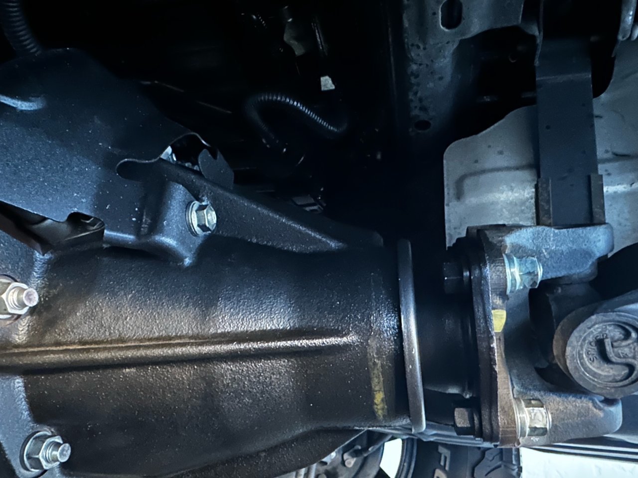

    Hit 500 miles of my breakin period for my new 5.29 gears and did the differential oil change on my own. followed the instructions to the letter. took it on the highway for the first time to and from work today and saw a few oil spots under the car after i brought it home. was horrified to find oil sprayed all over the underside of the truck from the differential rearward. Anyone have any idea whats going on? the fill and drain seals do not have any oil around them.

    Could be a few things, namely poor pinion bearing preload allowing the pinion to move and kill the seal, or possibly a bad seal itself or a bad seal install. I’d take it back to the shop.
    If they change the seal, I’d tell them to use an OEM one.

    From the looks of it, the pinion seal let go.

    that pinion seal is leaking

    Pinion seal, as stated previously

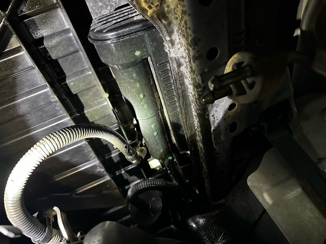

    The entire underside of the rear of the vehicle is covered in oil; like an oil filled balloon burst above the differential. The seal isn't leaking now, as in there are no oil spots on the garage floor, and I don't see any oil around the area of the pinion. Would the pinion seal leaking be able to cause that much oil in such little time?

    all over the front of it, both left and right until you hit the leaf springs. There is enough oil above the differential hanging from the bottom of the truck to drip, and a large amount on the fuel tank cover near the pinion.

    Maybe you have a transfer case leak or a front diff leak that is spraying backwards? Can you find anywhere the wetness would have actually come from? Like one of the locker connectors? One of the diff bolt holes or the diff gasket, etc?
    Take off the 2 bolt locker connector shield and see if any wetness is in there. It’s gotta be a bad leak to be getting all over everything like that…should be obvious to find. If not anywhere on the rear axle, then I think you should look closer to the front.
    Still doesn’t make any sense just from you simply draining and filling.
