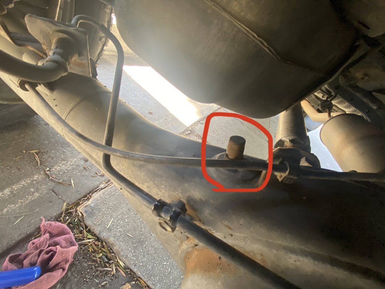

    Weird, my dif doesn’t have a breather tube DDC15C88-7C92-4733-9E11-96E8CAE6B406.jpg

    MikefromCT
    MikefromCT Well-Known Member
    Oct 23, 2018
    #270327
    3,168
    CT
    2013 TRD OR DCSB
    OME Bp-51; Relentless Armor
    This thingy
  8. Mar 17, 2021 at 11:47 AM
    #28
    MikefromCT
    Oct 23, 2018
    #270327
    3,168
    CT
    2013 TRD OR DCSB
    Many people who wheel swap that piece with one you can hook a fuel line up to. The new breather goes on the other end of the line. They run that line to a higher location (gas tank door or bedside cubby) to raise the breather location to minimize chances of water entering the diff in water crossings. That fluid in the diff expands as it warms; contracts as it cools; the breather allows for this expansion and contraction and and this simply relocates the breather to a higher area.

    You should be able to turn the cap at the top, some times they do pack up with mud but if it's stopped up more then likely you will have a leaking pinion seal.

  11. Mar 17, 2021 at 2:59 PM
    #31
    MurderedTacoV2
    MurderedTacoV2 Booty Admirer
    Feb 22, 2016
    #179098
    2,274
    Adam
    Hudson, New Hampshire
    06 Taco TRD OR
    3 inch lift, B110’s, Dakars, Dirty5’s, Dual Locked
    had this happen on my truck recently. Bolts were finger tight. snugged em as tight as i could with a 1/4 ratchet and sprayed it off. hasnt come back.
  12. Mar 17, 2021 at 4:38 PM
    #32
    winkel
    winkel Well-Known Member
    Dec 24, 2015
    #173039
    2,662
    Corydon, IN
    2014 Spruce Mica, TRD Off-Road, 6 Spd Manual
    Sliders, Tailgate Liner
    Yep, check the torque on the nuts and check that your breather isn't plugged, then clean the area and keep an eye on it. If the fluid isn't hitting the ground, I wouldn't worry about it beyond that.
