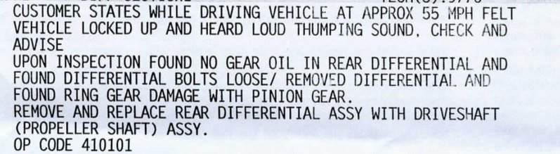

    "driveshaft with Propeller assy"? They didn't replace the diff? Do you have any more information?

    Exactly, that whole final drive needs to be removed and disassembled to see what happened. I REALLY would love to see a scan of the dealer reports.

    Sorry, I was half asleep when I was typing this morning.
