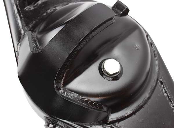

    Seriously? it's simple as it gets. Many companies make weld on bash plates. Replace the 3rd with new shafts and it's a much cheaper and stronger in the end.
