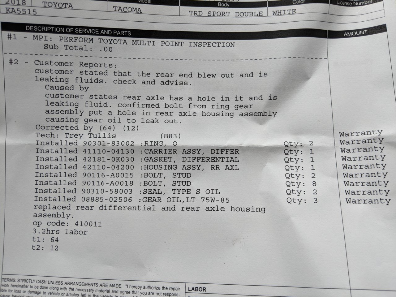

  9. Feb 20, 2020 at 10:34 AM

    Finally got it back from the dealer. Asked to get pictures from the mechanic but they called and said it was already packed up. Picture attached basically sums up what their conclusion was but I know nothing of differentials to make any sense of it...IMG_20200220_133355.jpg

    Yeah man. That's insane. Hard to imagine a ring gear bolt backing off. Wonder how long it was kicking around before it actually locked up.

    Also super lucky they were able to trace it back to a cause that was covered under warranty. Most things like this are almost always put on the owner because it looks like abuse and is hard to trace. Kudos on them for putting the time in to find an actual cause.

    That's pretty cut and dry though. Bolt backed off and grenaded the diff. Has to be warranty.

    Well yeah. I just mean them actually taking the time to isolate the cause. Unless the bolt was still bouncing around in the inside (possible) they could turn around and point ar the owner.
    Not like that’s never happened before. lol
