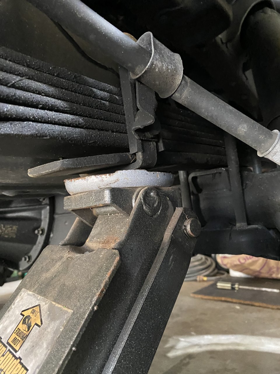

    This pic might help where to put the jack. You don’t want to lift any higher than to get just a bit of space between the pin and axle.
    It might take some luck to get lined up right and once it is, you might need to use a breaker bar or something to move it slightly left or right, using the shock as a fulcrum.
