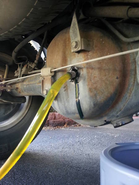

    Decided to document it just in case it could help somebody out. It was a piece of cake. Took me longer to clean up my mess than change the oil.

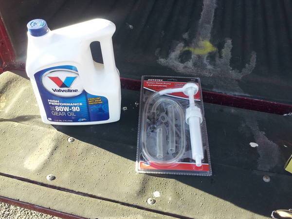

    All I needed was a 24MM socket, 1/2 drive ratchet, I used a 1/2 drive breaker bar but I don't think I really needed it.

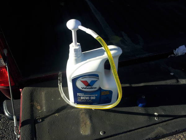

    I bought this oil and cheapy hand pump at Autozone. The pump worked remarkably well.

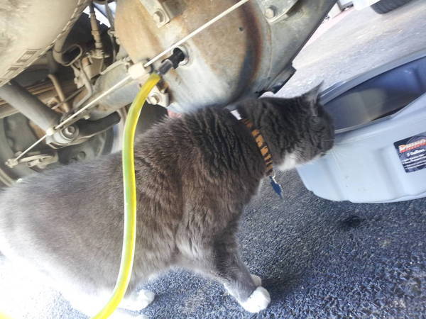

    Drain plug is on lower right, fill plug of course is on the back. Both are 24MM. Simply remove the drain plug and let all the old nastiness out.
    I quickly had unsolicited supervision.
    Followed by more supervision.

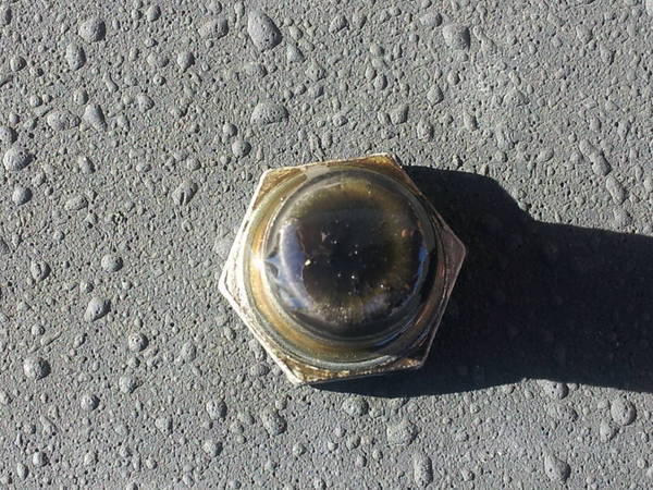

    Also you can tell what the clean oil going in looks like going in. The stuff that came out was pretty nasty. 124,000 miles and to my knowledge it's never been changed. I had a few little tidbits on the magnet.

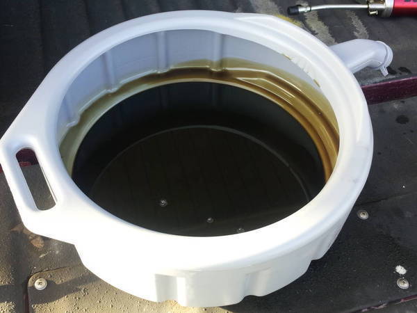

    And this is how the old oil looked:
    So basically drain the oil, then replace gasket on drain plug. $2.37 from Toyota - P/N 0 12157-10010. Put in new oil through fill hole. I simply filled until it began to dribble. Was pretty close to 3 qts.
    Then with new gasket installed on fill plug, re-install fill plug. Easy peasy. Hope this helps someone.

    Yeah, it was like 5 or 6 bucks, worked like a champ. Buying the gallon jug was just as much as buying the 3 individual quarts, so the pump worked out well. It was quite a few pumps. Says it delivers one oz. per pump.
