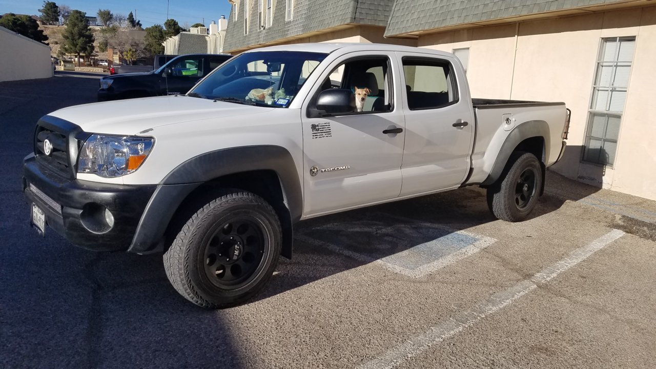

    I have an 07 pre runner 4.0v6 4D DCLB that doesn't have a locker, trac control, and none of that good stuff haha. I've thought I've read before if I don't have the LS sticker on it, I don't use it. If I am on the right track, what should I get in the 75w-90?? I wanted Mobil 1 but it only comes in LS -_-

    Just curious if your fuel door hinge is failing like mine (same year) at the hinge. Also what is the star on your door about.

    am i the only one that looked for a handicap placard

    Look closely at the driver.

    Bottom of the windshield? Is that what they use in what appears to be tx?

    No, I meant the little dog. Hehe. I’m sure it’s difficult for him getting in and out.
