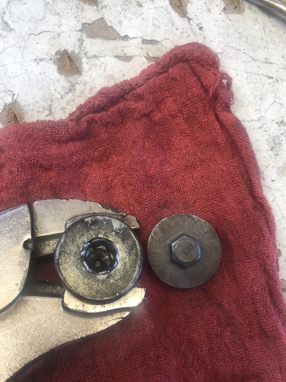

    C4179E7F-7A27-4410-9873-0DEB2FD8EB06.jpg Just got some stuff from down under today I will post how it works either way it's cool and going in the toolbox. Like most things with these trucks it's a little expensive but hopefully worth it.

    What’s this part?
  10. Jul 7, 2019 at 4:21 AM
    TheDevilYouLove
    TheDevilYouLove You can’t polish a turd, but you can polish a TRD
    May 26, 2016
    #187953
    2,887
    Steve
    Marylandistan
    2010 Tacoma TRD Sport Access cab 4x4 silver streak
    It’s to remove a stripped front diff drain plug with the 10mm hex fitting. Kaon tool.

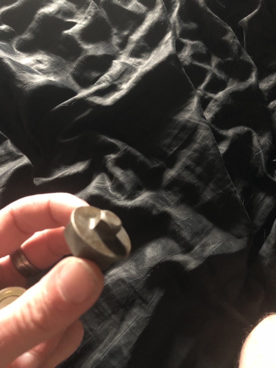

    I don't know if I posted the pictures correctly but the kaon tool worked perfectly. Great investment.

    That's the plug it was able to bite into and remove.
