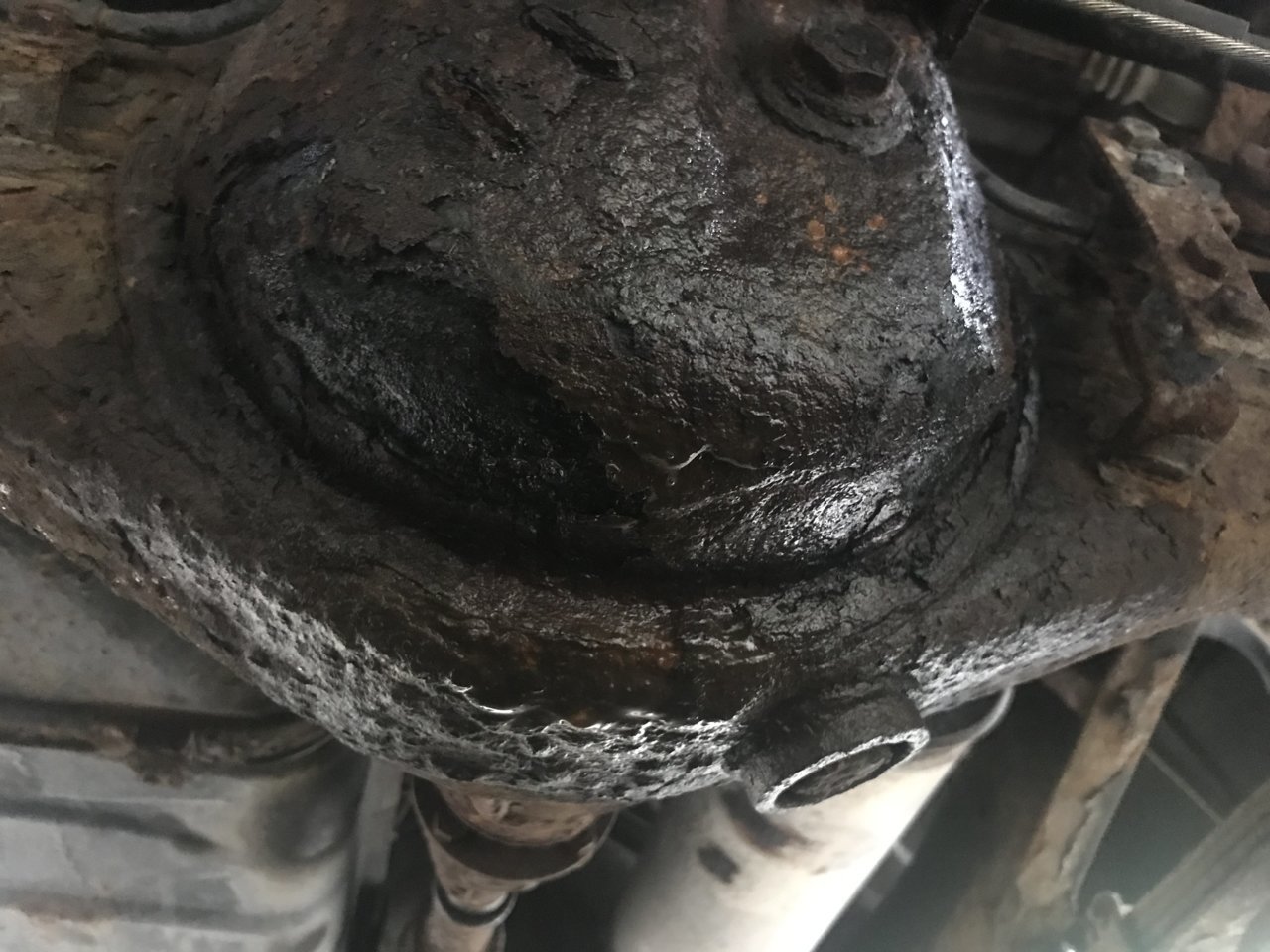

    i was wondering why my truck smelled like a skunk yesterday, and when I looked underneath I saw oil dripping from the rear diff housing. After poking around for a few minutes, and knocking off a layer of rust, it looks like there is a rust hole somewhere on the back side. This truck has resided in the northeast its entire life, and it shows. However the frame has not rusted through anywhere (yet - and it is out of warranty now).
    Anyone have a quick fix, or better yet, a replacement rear diff? I would even consider a parts truck with a sound frame since I’d like to keep this one up and running for a while yet (I don’t expect the frame to last much longer).

    Depends on the hole where and how big. Weld it up.

    Forgot to load the pictures:
    12AEEDB1-C80F-447F-8C7D-9F70034F6B64.jpg 50083A78-8EF2-4550-A219-B68E9156990A.jpg

    Holy shit! Not sure there would even be enough good metal there to weld on..
    Can you at least get the fill plug out and keep the oil topped off in the meantime?

    Yeah, she's not a good looker underneath. You would have though, and expected, that the frame would have failed years ago. My dealer was not able to fail it under warranty, although they tied several times. The e-brake cable hanger in the picture has broken loose also.

    If there is enough sound material around the rear cover, you could cut it out and weld a new cover on. From the looks of it though, you’re probably better off replacing the entire housing. I will have a non e-locker housing up for grabs in the next couple weeks, but you can probably find one a lot closer. I would feel bad condemning my axle to a future of cancerous rust anyway lol

    This looks like an interesting option. I've got a stick welder (welds hold my skid steer together) and I recently inherited a mig welder, but have never used it.
    While this rear does not have a locker, I'd love to replace it with one that does. It'd have to be an '03 or '04 with ABS though.

    This, they make em for the 8" elocker and also for the 8.4" non elocker. I have one of these covers on my 2nd gen. Instead of the factory tin foil, it's now 1/4" steel and went from 3qt capacity to a 6qt capacity.

    Don't know if it'd work, but possible cleaning up that rear axle enough to be certain where leak is and possibly use some of that 2 part mix epoxy stuff to plug it up? Don't even know how well that would work. That sucks dude

    Looks similar to the one on my '99 when I replaced it. I also went with the Barnes cover. Word of advice- weld (or have somebody do it for you) a crossbar or a stop onto the inside of the cover where the fill plug is. They don't (or at least they didn't) have a stop in there, so you can just keep threading the plug in until it drops in to the diff if you're not paying attention.
    As to enough steel to weld the new cover on, the surround on that axle housing is pretty thick, and it's load-bearing. So if you haven't broken your axle housing in half by now, you've got plenty of steel to weld the new cover to.

    In the meantime you should try to clean it up a little and just slather on some jb weld. Thats what i did to my 4runner diff a couple months ago to stop a leak like yours and its still holding up great.

    I scraped off most of the flaking rust, but still could not see exactly where the leak was. Checked the oil level, and it was only down about 1/2 inch. Pretty slow leak. Cleaned it up and I was going to check it after driving. Then it rained all afternoon.
    The more I looked around under there, the more disappointed I became. The exhaust system is bad, including the cat connections. The rack is leaking. Rust, rust rust. I'm considering moving on, unless I were to do a frame swap on this one. Then I would be dealing with all those issues anyway. Removing any part from this truck is going to lead to complications due to rust, including any work on the rear end.
