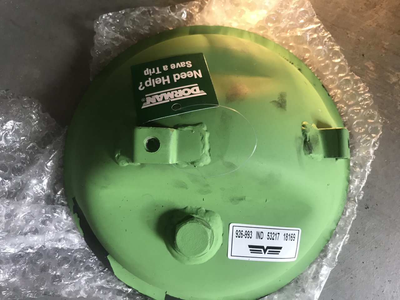

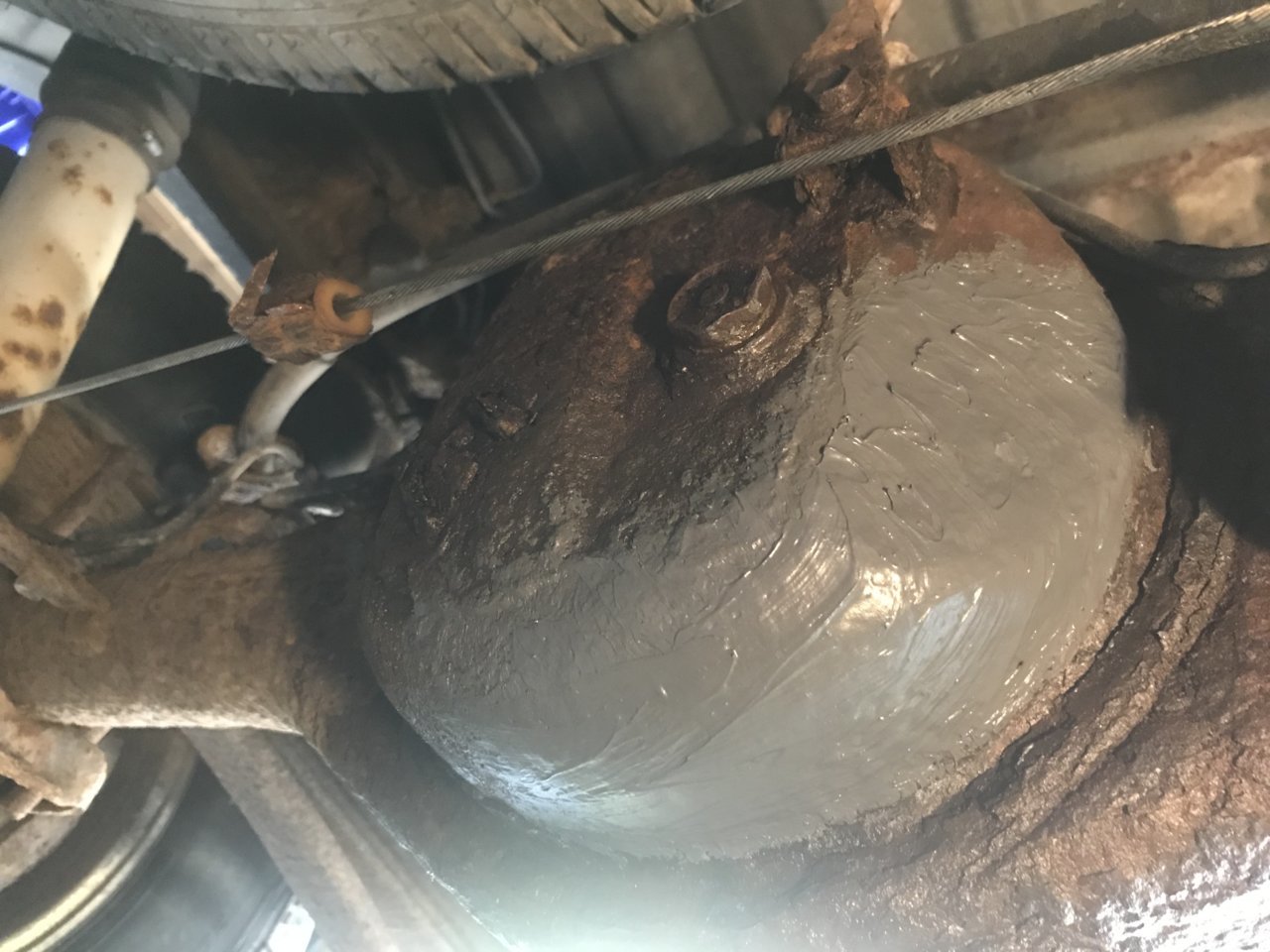

    077A7D6A-4872-48A1-B3A9-3179A5631CC0.jpg Got the Dorman dif cover, and I’m surprised by the quality. Much thicker and better made than I thought it would be. Used the J-B weld on the old one and it came out quite well. Only problem is I didn’t get all the leaks covered, so did round two today, and will check it out tomorrow.C2FC1E22-43B0-43A2-9027-0F6852BB9361.jpg

    Holy JB Weld!! :eek: :rofl:

    It's pretty ugly, but if it buys me some time, great!
    The missed leaks were above the oil level, so they did not show when parked. I think I got them though. Will know later.
    EDIT: JB Weld - miracle in a tube!

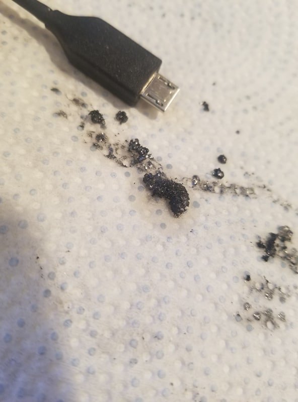

    I have a pic of how much metal came out on my phone somewhere. Let me see if I can dig it up. it wasn't as much as i was expecting and I know he didn't clean it out before cutting.
  10. Aug 13, 2019 at 10:39 AM
    #30
    RobZ9132
    RobZ9132 Well-Known Member
    Apr 23, 2019
    #291111
    205
    Somewhere in NC
    2004 Double Cab TRD
    I found it. This was removed with a Qtip. He has the valley style magnet.
