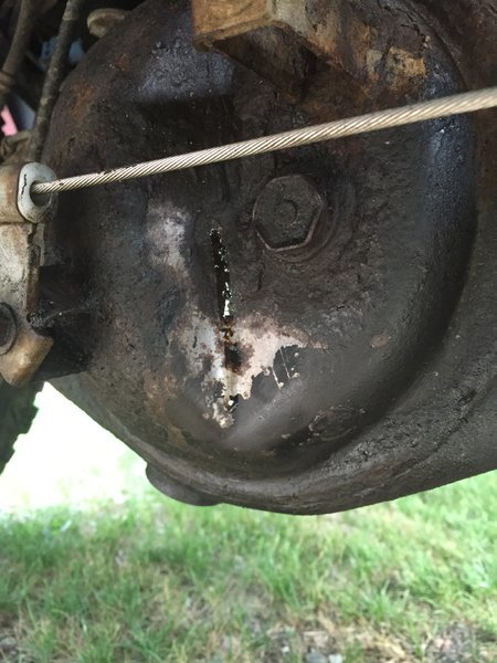

    Thanks guys, the axle housing itself is fine except for one small hole where the fluid leaks out when driving the truck.
    This picture is from back in July when it started to get bad, since then I've been religiously patching with JB weld and its just not doing the trick on longer drives. I drove from VT to ME on friday and now the rear end has started to whine... So friday night I bought more gear oil and before re-filling it I noticed that the differential smells burnt.

    Damn! Is that from rust or a serious impact to your rear end????

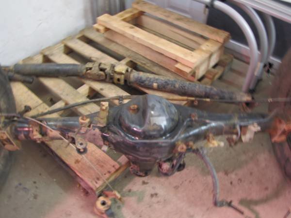

    I've been keeping it patched with JB Weld since June, it was time to bite the bullet and replace it.
    Picked up this today!

    Wow if you were close to me I would love to buy your old housing .
    It seems this rusting out is pretty rare I have been looking for a rusted housing for about 5 years I have yet to find one within a few hundred miles of me.
