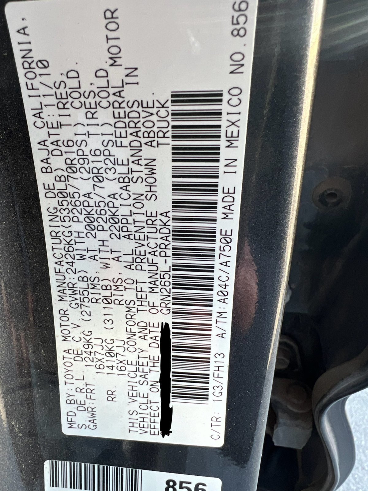

    Hi everyone quick question I recently had to swap out rear differential on my 2011 Taco 4.0 seal was leaking for a while and due to that low to no oil and bearings were all pitted and no good (according to my mechanic) I recently got it back and now runs at a little higher RPMs not much but I do notice it and the fuel gauge noticed too . I am thinking the new rear end is geared lower ? What are your options on this ?

    1GR 4.0 trucks came with 3.73 gears
    The 2TR 2.7 trucks came with 4.10 gears.
    The rear ends and carrier will bolt up between the two.
    Maybe you got a gear set from a 2.7 truck?

    if you notice that the rpm are higher, then yea. you most likely got a diff with a higher diff ratio.

    So you should be able to jack the rear up. Turn the drive shaft and compare the number of rotations of the tire to the drives haft. Should be 3.73 turns or 4.1 turns....roughly. those ratios are sorta close so that may complicate it

    thanks everyone for the feed back going to get a new diff thanks you guys are a ton of help I really appreciate all the help.
