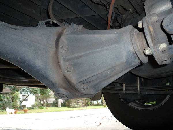

    Here is what mine looks like... so if i find one that looks the same i should be in business right?

    If it doesn't have a diff locker, than yes it can be swapped... at least thats what I got from that site. If you pull your 3rd, buy a gear set, and bring the 3rd member in to a shop, it shouldnt cost more than $400 total.

    4.56's will probably be overkill unless you're going to be running 35" tires. If you're going for 4.10's then it's most likely going to be a used set that someone took out of a truck, unless you order the gears from Toyota. The differentials that will work with your truck are non-elockers that have the new style bearing cap. The bearing cap is shown in the picture below. It's what the bolts are being removed from in the picture.

    What size tires are you going to run? If you are auto, you should get 4.56 if you can find them, but 4.10's are most prevalent. 96-04 non e locker axle 3rd members should fit.
