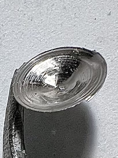

    Changed the oil in the rear diff on my 2022 Sport/manual trans yesterday. I have 6,700 miles logged. The plug with the magnet was filled with ferrous material,(black) and a 1/4” round metal cap thing, conical looking was attached as well!
    So I wondering where this metal cap came from and for the miles there was sure a lot of metal in the cap and the oil was quite dark! I changed the transmission oil a week ago and it was surprisingly filled with metallic metal. Not ferrous, I would guess brass and aluminum. So the upshot here is I believe that it would be a very good idea to change out the fluids after the first 5,000 miles logged on a new Tacoma. By doing do one will clean out the break-in materials that are floating about which affect the bearings considerably. Any one have any ideas regarding the metal cap I found in my diff?

    Pics would be nice. My guess is it’s a remnant of machining process
