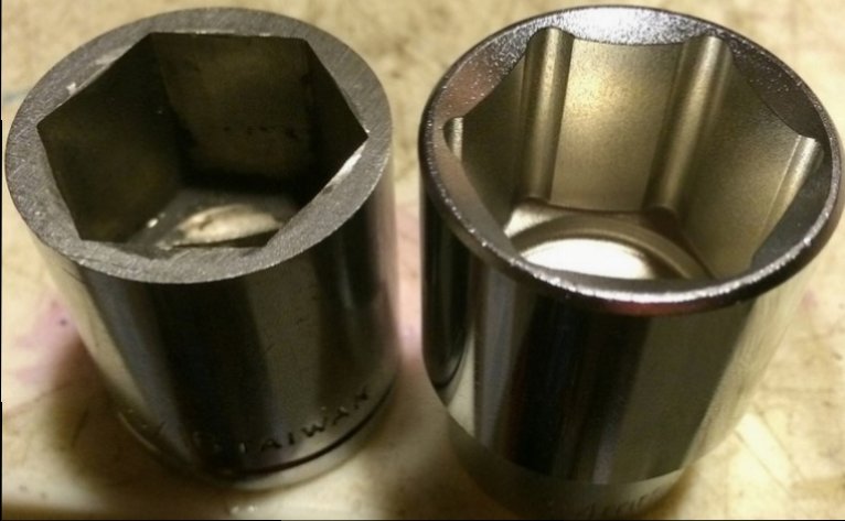

    What makes it worse is that they make the heads of these plugs so thin. If you look at your sockets, you'll notice the end is tapered. That combined with the thin head leads to a greater chance of stripping the plug. What I did was used my 10-inch grinder to 'flatten' a 15/16th inch socket I had laying around. That adds a much needed 1.5 mm of extra grip. Fits the plugs on the Tacos and the fill plug on my wife's Lexus ES350. The tapered end is suppose to make the socket slip onto the bolt head easier, but it can strip a thin head as a result.
    See:
    DoorDing, Hartford, Justified and 4 others like this.
