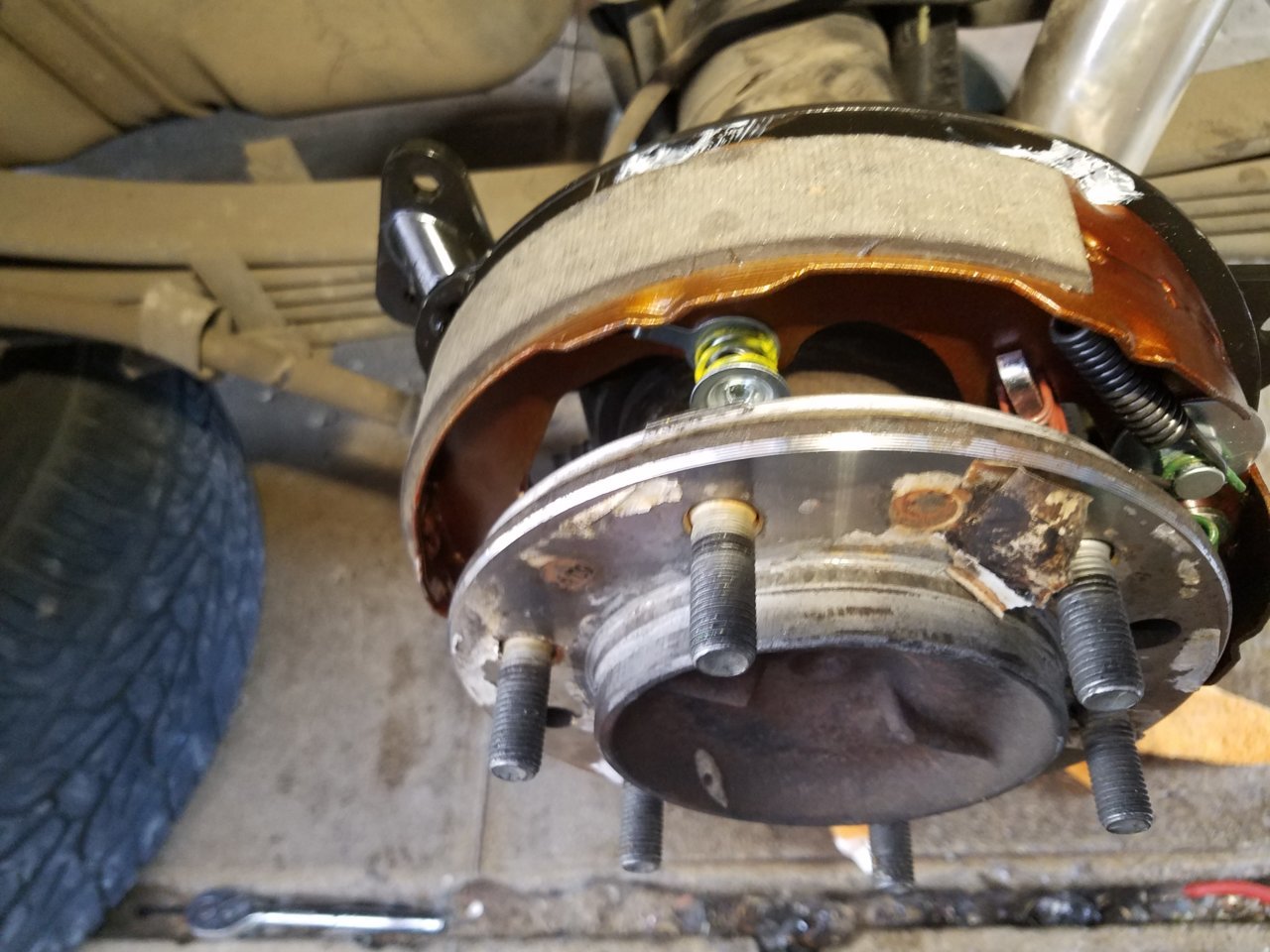

    So found when installing front park brake shoes on sos kit unbolting backing plate and turning so shoe on top there's a lot more room to install hold down spring retainer . Just need to hold bottom of backing plate to axle so got the angle for more clearance .
    Didn't install master yet but works great with out it .Just that pedal feels a little on the soft side .Will install tommorow .

    Not to be a dick but I believe the driver side is clocked wrong. Here's mine as an example. Where the pivot bolt is should be on top.
    Biscuits likes this.

    I had it unbolted from axle so I could angle backing plate so I could put on hold down spring . Made it easier . Judt posted pic to show more room to install hold down spring .
    Saw your pics of install . Helped a lot

    Yea that's why posted pic of backing plate angled . In case anyone was struggling like me lol. Lot more room to install front shoe hold down spring . With it bolted up got like 3/16 max to put it on :facepalm:.1st one took me a few hours :eek: lots of swearing to install till I unbolted plate and angled it . Other side like an hour to install shoes and backing plate .

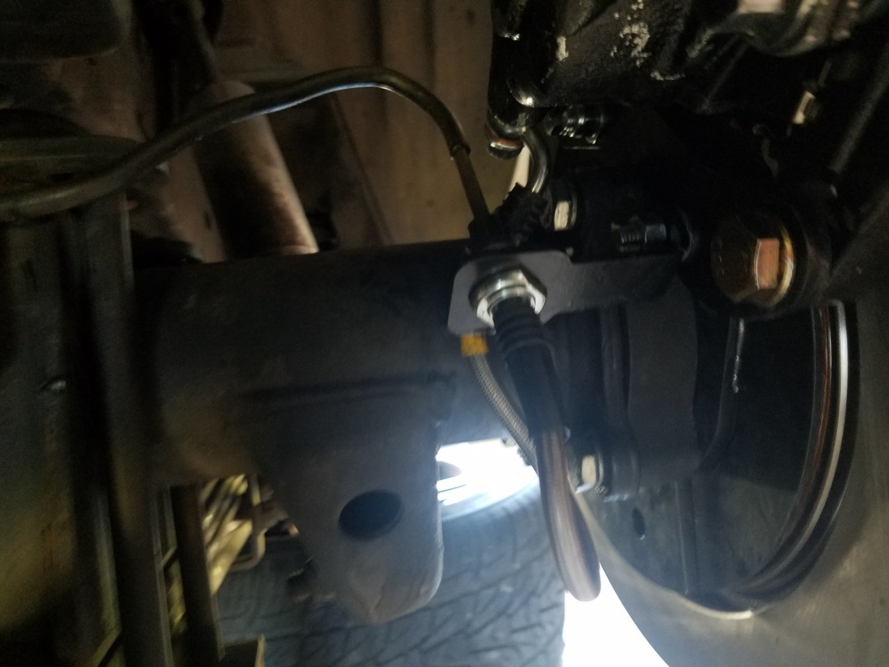

    Edit .Added pic of brake line . Was going to install and was like installing with flex line mounted in slot for banjo fitting was like WTF .Then I read the instruction lol. Said dont install with banjo fitting in slot lol.
