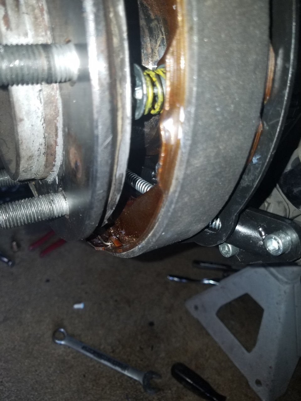

    The original poster of this thread is looking for a disk brake kit or information about one. aaaaaaaaaand what do most of you idiots do?? you reply with dumb arguments about how "drums are better" "tractors have drums, so my tacoma is a tractor" "i no maf gud, but insert equasion her".
    The drums are total garbage on a vehicle that goes fording.
    who else has gone fording or launched their boat and then the drums seize up? now your truck is a paperweight and you can no longer tell people how reliable your precious taco is...
    I ended up drilling a 3/8" hole in the bottom of the effing drum (straight down from the adjuster slot)
    if I get them wet, I spray wd-40 in the adjuster slot (after parking it)
    when i go to leave, I spray them out with brake cleaner (it can drain out of the bottom hole)
    Its either this effed up procedure, or an even more effed up procedure involving 4Lo and/or lots of cursing/hammering
    Disc brakes dont have this problem and are easy to keep clean regularly.

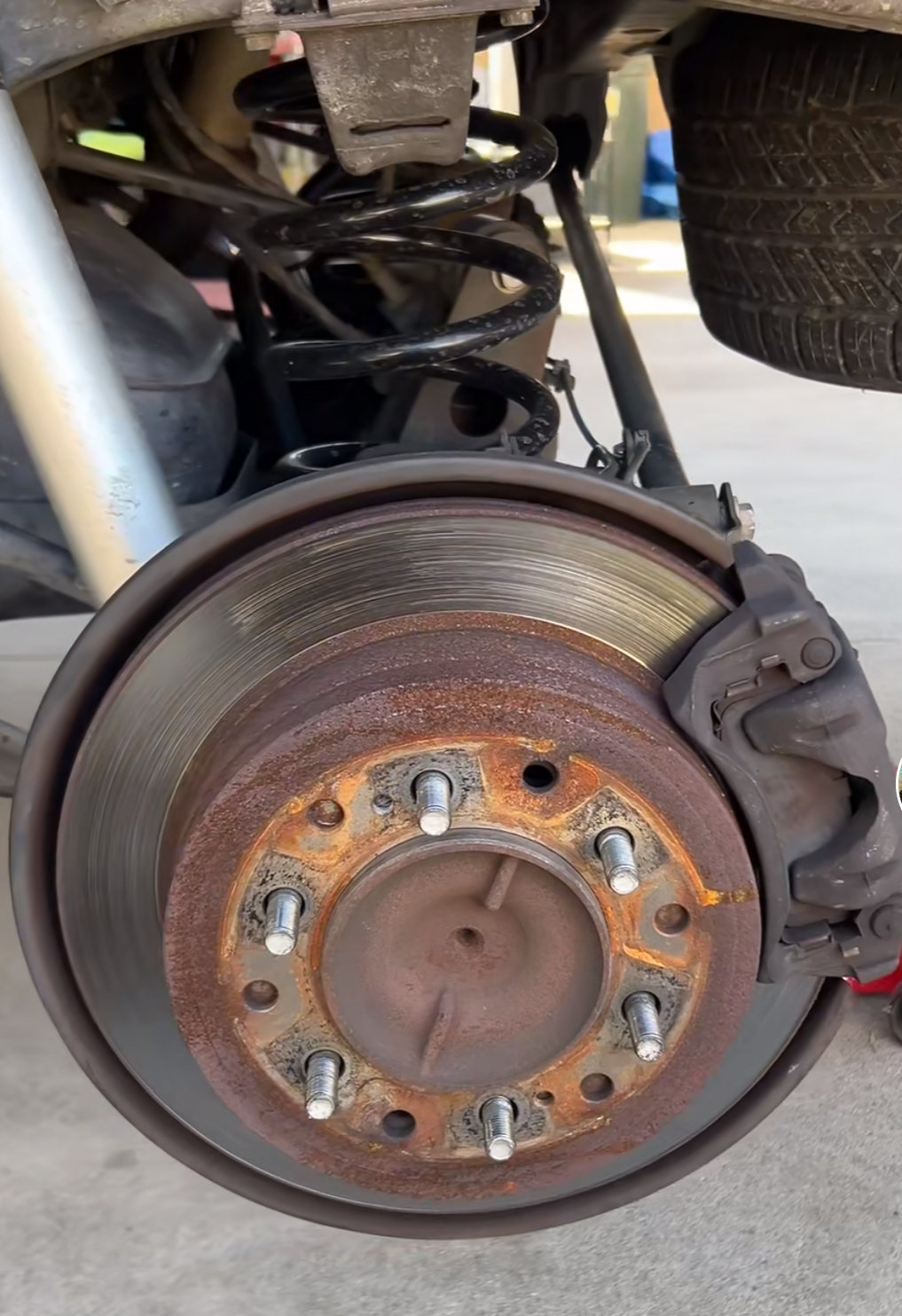

    so today I found out apparently 4th gen T4R comes with rear disc brakes.
    It seems like basically a Tacoma. But with an enclosed cab.
    has anyone successfully put that system on?
    I’d imagine its the cheapest, available, and probably correctly weight biased
    to pretty much get 4runner parts from a junkyard.
    I’m guessing the ebrake might be a cable style. Ratcheting mechanism on the back of the caliper
    Unless it’s an internal drum ebrake inside the rotor
    which judging by the width of the above rotor hub barrel pic, and gaping hole on the hub, it might be. Like a star tooth adjuster in the hole

    the sos kit implements 4runner calipers, rotors, and parking brake

    @Lucario Runner noted it. You will need a bracket or make your own but SOS already did the work for you. It is def a drotor for the e brake and since the 4runner is smaller drum the e brake is not as good for the Tacoma, its even mixed on the 4runner. @Lucario Runner and I both have the rear kit installed. Besides the e brake It was a nice add.

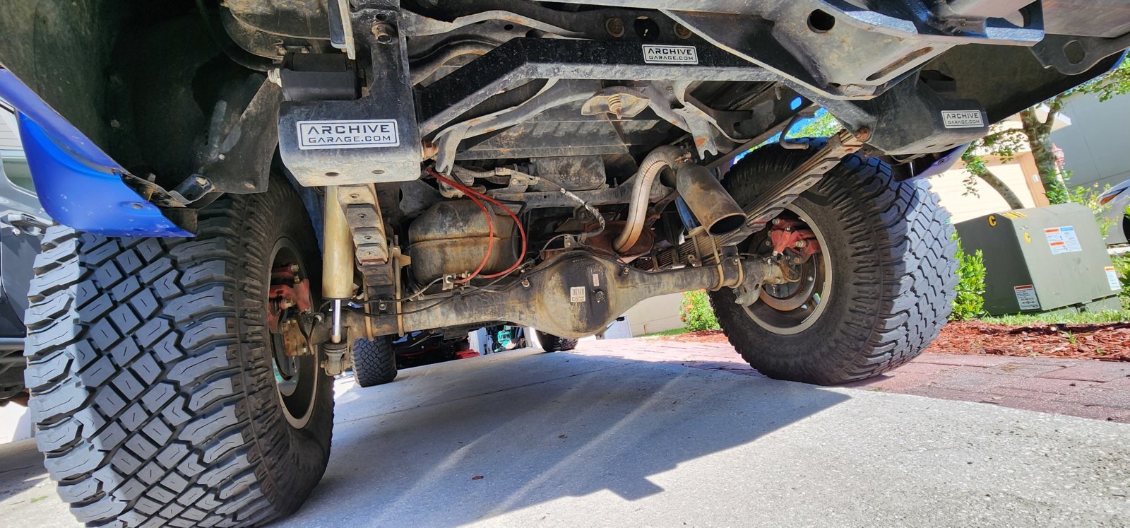

    MA_TACO
    MA_TACO Well-Known Member
    Jan 28, 2018
    #242689
    670
    Wesley Chapel, FL
    I did the SOS rear disc brake conversion a while back and it comes with a master cylinder. My truck weighs 5700lbs in full form and needed the extra stopping power. Stops on a dime.
    TomTwo, Kolter45 and Torspd like this.

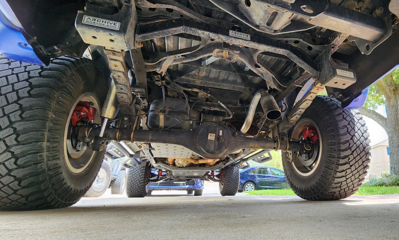

    MA_TACO
    Jan 28, 2018
    #242689
    670
    Wesley Chapel, FL
    That was an old picture when I first did the conversion. Here's an updated one with longer brake lines.
