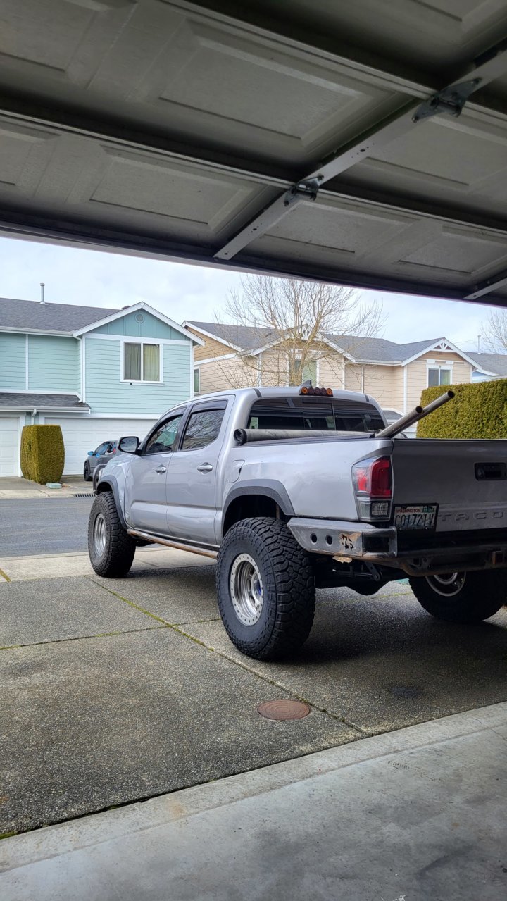

    Been running the Tg disk rears for 7ish months now, no issues with 37s. Brake bias is pretty much 50/50. Went through one set of pads, and they cost me $25 at Oreillys since my kit just uses s10 brake parts.
    No brake fade, no blown cylinders, no brakes getting frozen/jammed, and I even carry my old drum wheel cylinder for when someone else blows one out on the trail.
