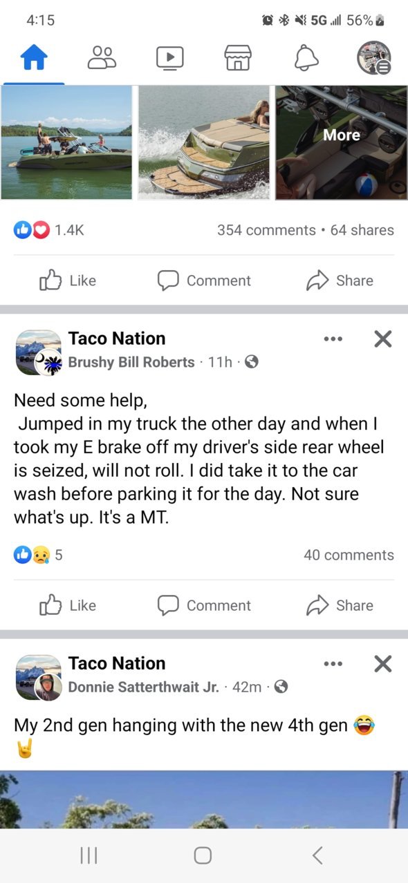

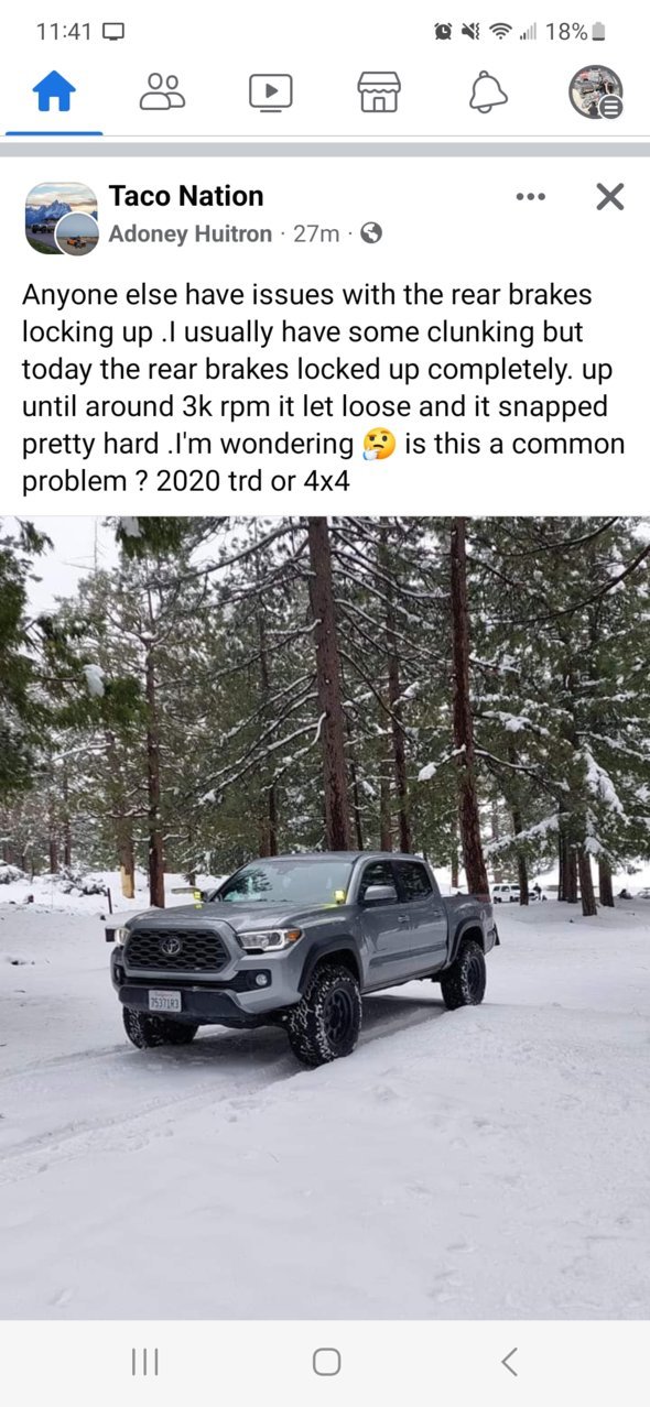

    Nobody:
    Shitty 3rd gen rear drums:
    Screenshot_20230518_234133_Facebook.jpg Screenshot_20230518_161556_Facebook.jpg Screenshot_20230518_150341_Chrome.jpg
    Just a couple screenshots from the last couple days lol
