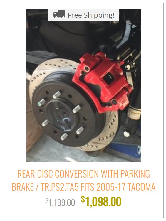

    It is not just to look cool, for those of us with 1000+ lbs of crap ( including 35's ) added to the vehicle the OE brakes simply are not strong enough anymore. If the SOS rear disc conversion kit is installed **properly** which includes swapping your master cylinder to the same unit used in a Sequoia then you have just installed a system for a 7000 GVRW truck onto your 5000 lb OE Tacoma or 600 lb "expo'd " Tacoma and you are clearly enhancing your braking capabilities by large percentage. SOS is currently beta testing the kit that includes the master cylinders with adapter plates to bolt right up to our trucks....ask me how I know :)
    Just to clarify it does not cost $2800 to do a rear disc conversion, the basic kit which gives your the same rear calipers that the T4R and Sequoia use is only $1098. From what I understand the master cylinder kit is not going to be much at all...stay tuned as soon as it is done and tested it will be posted, there are a few of us testing it currently with the different variations of OE brakes and OE masters.
