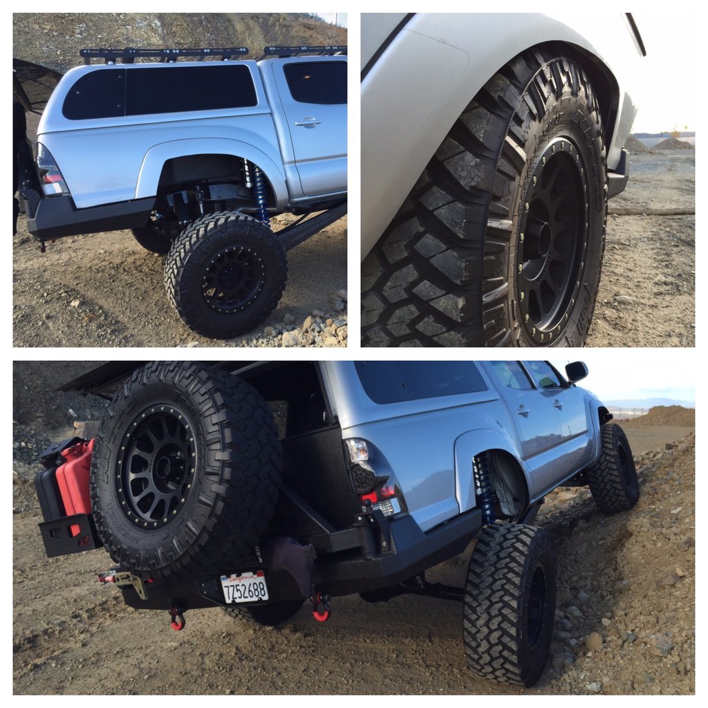

    Just because ABS kicks in does not mean your are getting any better braking, my ABS is f-ing scary and my braking distances are absurd because my OE system is trying to stop a pig that is severely overweight. Alpha tests have already been conducted using the master cylinder conversion with great results and betas are in progress, I'll have results to share soon.

    Your truck is essentially stock weight which is why you feel the brakes are fine, put 1500 lbs in your truck ( loaded expo build ) and daily drive it and tell me how wonderful those brakes are...

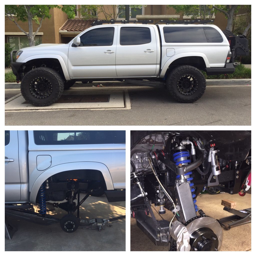

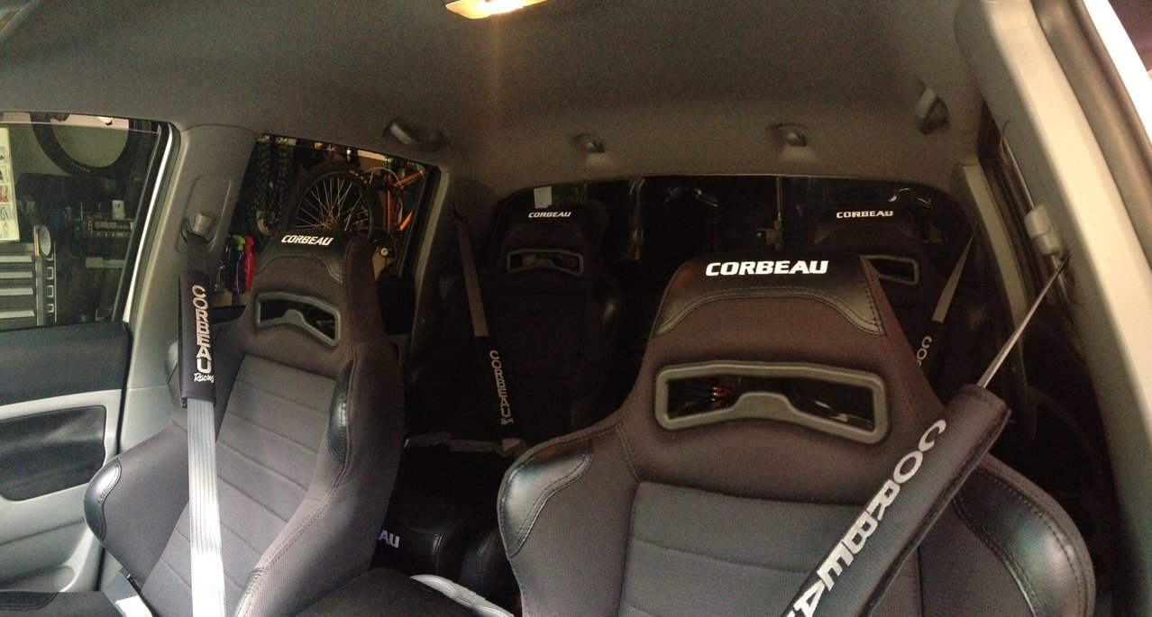

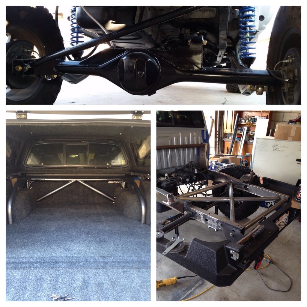

    No build thread, never been motivated enough to do it and I can't handle rejection...just the same shit everyone else has ( sliders and full skids we're off in these photos ...that's another 300 lbs )IMG_0601.jpgIMG_0265.jpg IMG_0602.jpgIMG_0361.jpg
