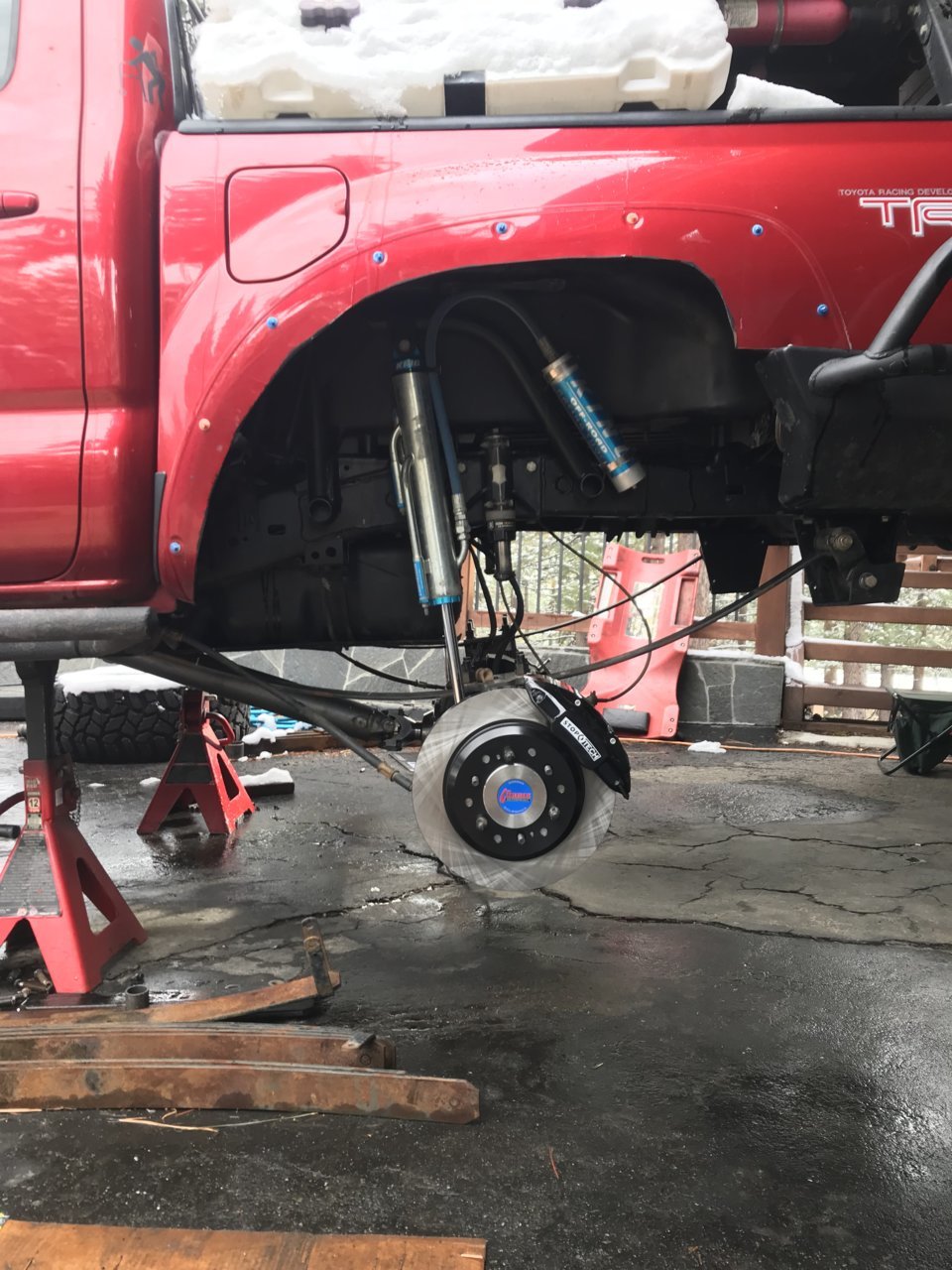

    Has anyone installed the rear disc brake kits available.

    I have seen a couple done one was a 2016 and other an 2018 and both love them but had a negative comments about the parking brakes kinda suck after doing because the surface contact area is greatly reduced and when wet they hardly work. <----those are comments from the two guys that did theirs not my opinion because I have not done it but been researching it Also other comments were that the pads do not last as long as the drum shoes.

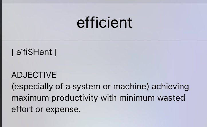

    Drums are more efficient then disc on the rear that’s why they are there... unless you plan on running Daytona. Better to put your money up front.

    Drums have a larger brake surface area which have more initial bite. They are not more efficient in terms of braking efficiency because they do not dissipate heat nearly as fast and fade exponentially faster.

    This is complete BS. The drums are fine, but they are not more efficient, nor is that the reason they are there. lol
