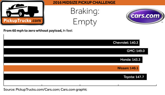

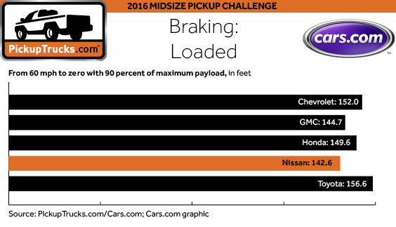

    Actually, yes they do, not that it matters because there is always room for improvement. Tacoma was second longest to stop empty and longest when loaded, which supports my theory of rears helping more when loaded or towing. Tacoma vs Frontier, Colorado, Canyon, and Ridgeline. Both stopping contests were won by the Frontier.
    https://news.pickuptrucks.com/2016/08/2016-midsize-pickup-challenge-acceleration-and-braking.html
    You have no data to support sales. There isn't an option for disc, and the Tacoma has always been drum, so there is no comparison to run. How many times is it discussed here? Apparently it is important to other people even if not you.

    You mean the test where it got last and second to last? That's one stop too... discs shine at shedding heat; not one quick stop. The fact is it was done to save costs and no other BS reason that people here come up with. Do they work fine for most people, myself included, yes.
    But it took 10% further to stop than the Frontier loaded but only 5% unloaded. Does your own example show the advantage of discs? I'd say that 10% is pretty significant. And yes, I'm bored at work today.

    its 8.9% vs the frontier but also 2.9% compared to the chevy with disks. also having driven the 2016 frontier im shocked it came in first. it had a terrible braking and steering feel. (so bad i still remember walking away thinking thats just not going to be fun to drive)

    I said significant performance gain... your data shows it's not. Compare it to the average stopping distance of the disc brake equipped trucks, the difference is negligible

    The Frontier stops 10%(9.8) quicker. 156.6-142.6=14 /142.6= 9.8%

    Dude, it's 10% better when loaded and the Tacoma is lighter weight than most if not all. That is significant. I have an 81 truck with drums too, that's because it's an old ass truck. Offer it as an option and see what the divide looks like in a year. I would bet money that discs take it. That's like you saying no one needs electric windows or locks. They don't offer ANY performance improvement. How the hell can you defend using drums? The only reason they are there is cost, not performance. The only argument is that you don't want to spend the dollars that it would have cost from the dealer. Other than that, what is the down side of discs?
