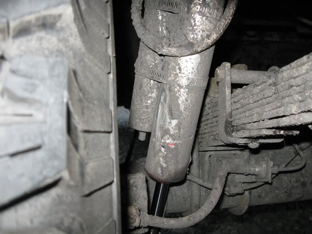

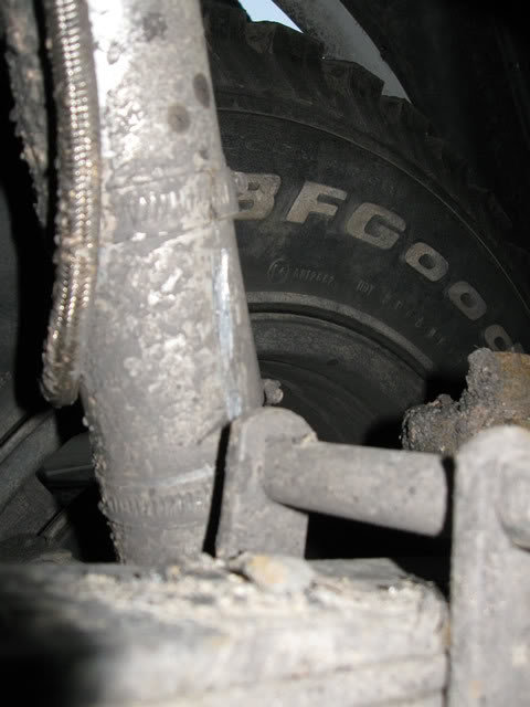

    I'm going to be blunt about this because I've covered it many, many times on this site.
    DO NOT INSTALL THIS KIT.
    Stopping power is reduced horrifically and it will eat your shocks. The driver's side caliper rubs the hell out of the shock when the suspension articulates, and for good measure it pushes the shock into the leaf spring so you'll have matching holes on both sides of the shock body. At least they're thorough.
    In step with all the other threads on this topic, feel free to argue in favor of the kit based on what the manufacturer tells you.
    As for things working with the stock master cylinder and booster, drum brakes require less fluid and more pressure relative to discs, which require more fluid and less pressure. No rear disc brake conversion can make the stock master cylinder push more fluid through the lines. Period.
    Replace you rear brake shoes, keep them adjusted, and be happy that things work they way they're supposed to.
