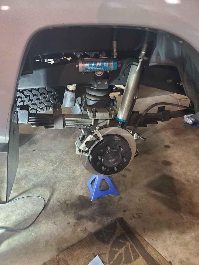

  9. Apr 3, 2025 at 12:18 PM
    ram1009
    ram1009 [OP] Active Member
    Feb 6, 2025
    #465460
    44
    Robert
    Tacoma 2008 Access Cab White 2.7L Engine, Auto Trans
    I don't expect a cost benefit. In fact there's actually a deficit for the extra parts plus labor.

  13. Apr 3, 2025 at 12:43 PM
    TegoTaco
    TegoTaco Well-Known Member
    Sep 29, 2016
    #198555
    7,233
    Ontario, Canada
    ‘13 SUPERCHARGED DCLB TRD SPORT
    Followed instructions. It’s correct. I was doubting it too lol
