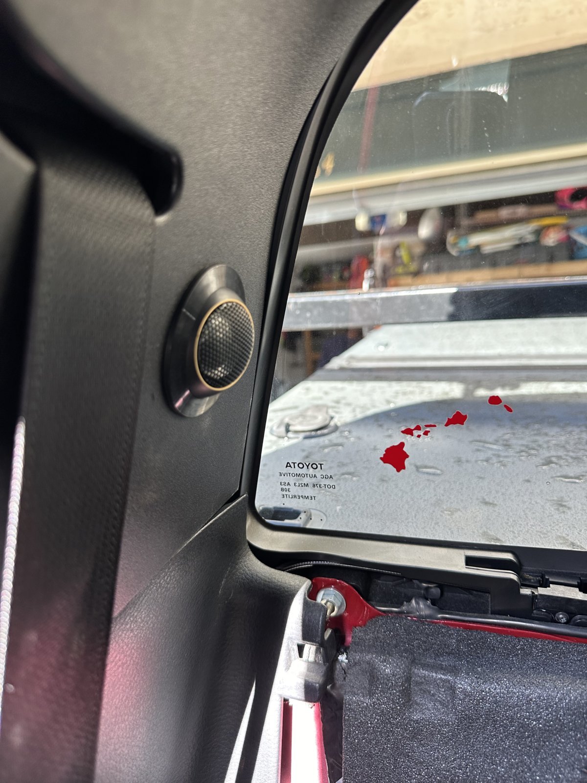

    I put tweeters in the rear pillars, sounds great.

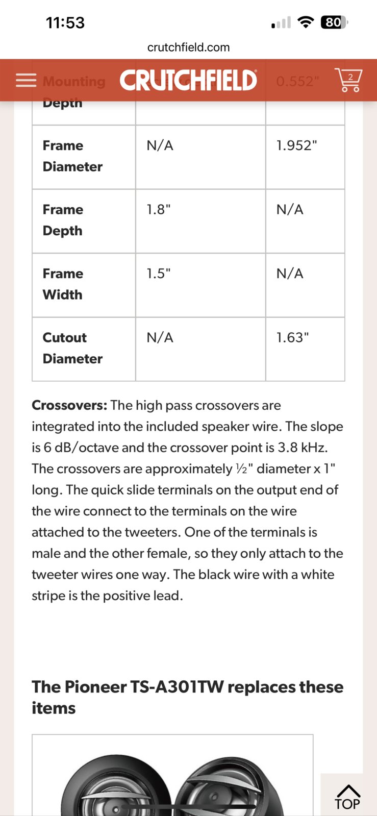

    The tweeters have an inline crossover…at least I think that’s what it’s called..

    which model are you looking at?
    so far, all my answers have been generic, as typical component sets include 3 pairs of gear. a woofer, tweeter, and a crossover unit.
    it's not at all typical that any aftermarket tweeter to have a crossover built into it.

    They are the Pioneer 6 1/2” component car speakers, model# TS-A653CH

    A quick description of the crossover for the tweeters on Crutchfield’s website-

    i see. yes, those are one of the very few speakers that have an integrated crossover on each part of the set.
