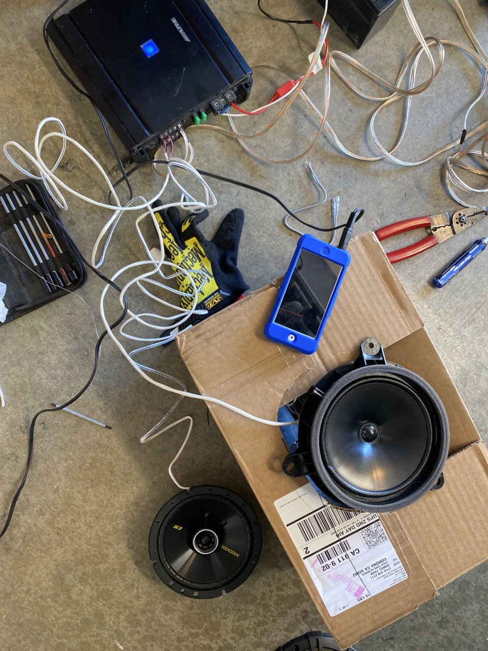

    well. I lost two of those white clips damnit. should I open the the door? or just buy new ones. lol

    You are 100% right! I just couldn’t take it anymore. I spliced into my factory crap speakers and powered it with a alpine amp! it’s not as crispy as kicker but it’s not horrible and handles the 50watts no problem. sorry
    I dont have a professional bench. I also did half stock and half kicker balance test and the stock actually has more bass!!
