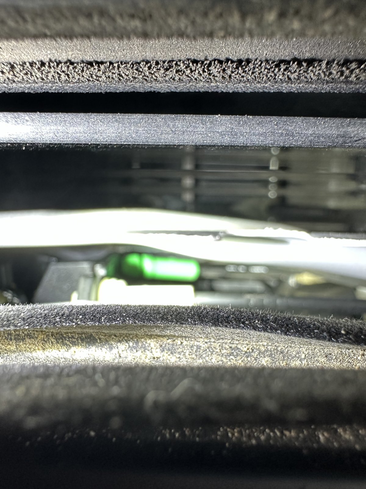

    Had this problem and rolled the window down and pulled the center of the door panel up and in and that allowed me to get needle nose pliers to set the green cable back in its retainer. Wouldn’t have tried this without this thread so thank you to all.

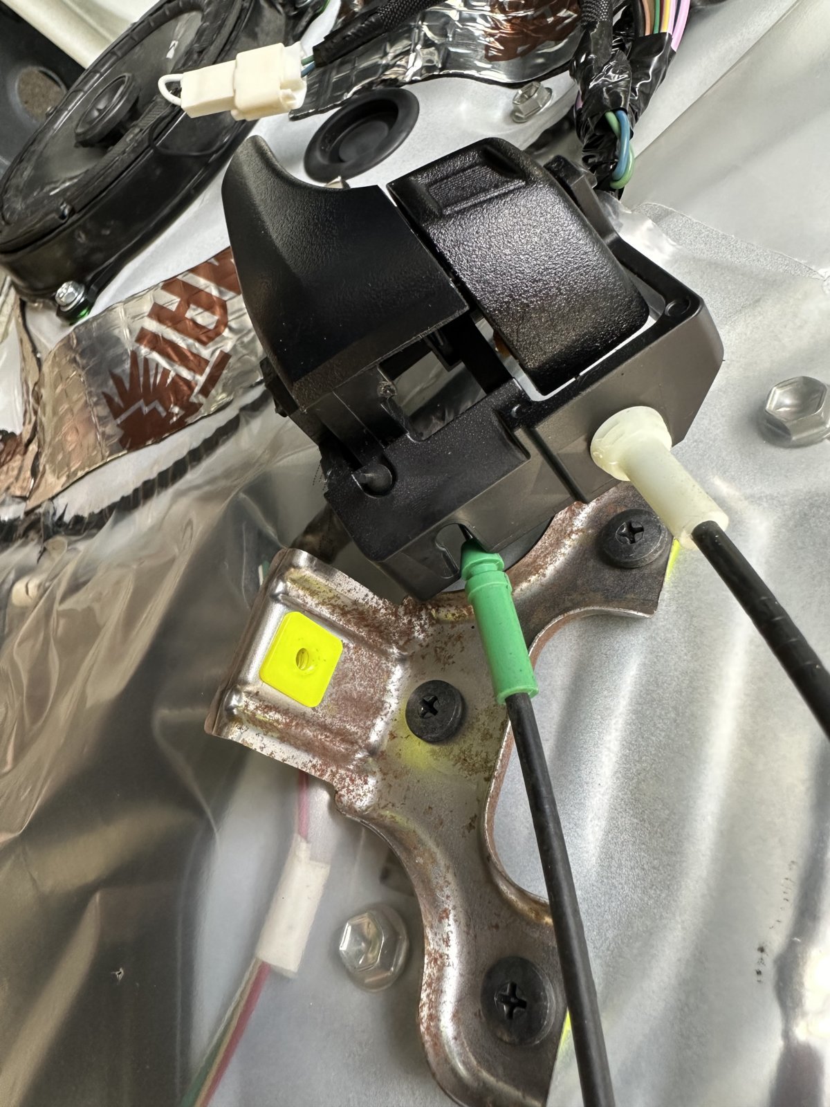

    Just fixed the same issue on mine after putting in new speakers. Was able to pop the door panel off and up enough to see the culprit and pull the wire to get the door open. Then reinstalled everything after putting the cable back in place.
