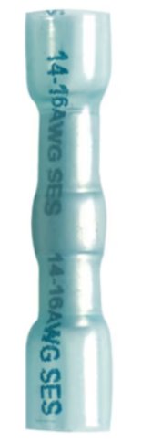

    But get yourself a pack of these crimp and solder waterproof butt end connectors from your local auto parts store. In the right wire gauge. You might need 18-20. Anyway, once you crimp the mating ends, then you apply heat to melt the solder element in the middle to strengthen the overall connection. The solder oozes around the individual wire strands and then of course hardens. I personally like a belt and suspenders approach and then slide a ~2" section of plain black heat shrink tubing over the top, which was pre-installed on either side of the wire - usually whichever that is longest. Heat that up too. Poof, that's a connection that will outlast your truck.
