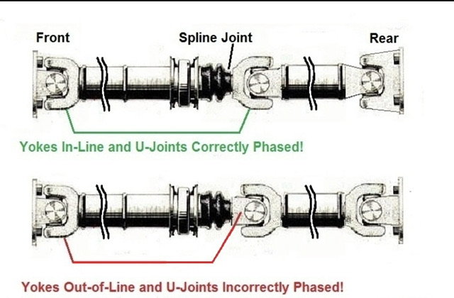

    Make sure all your drive shaft yokes are lined up. If not it throws the drive shaft out of phase.

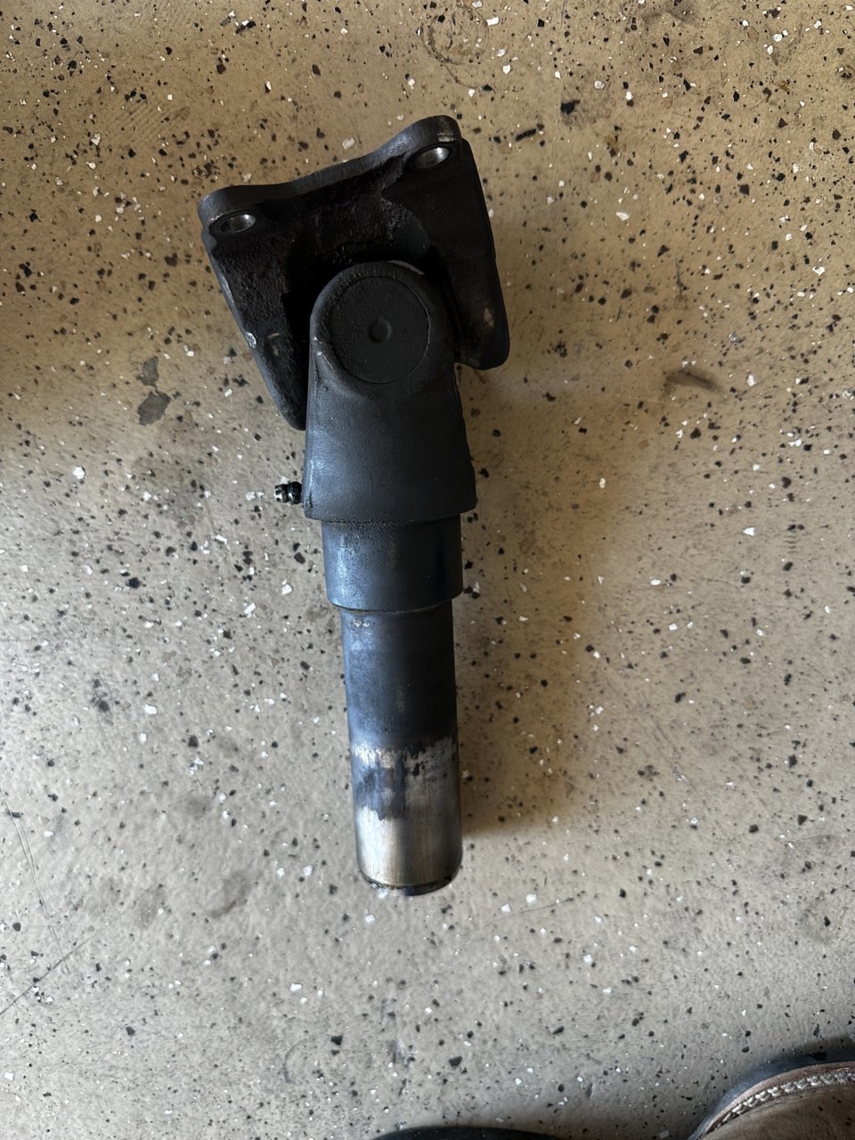

    So when I was replacing the cb, this part of the driveshaft fell out and there are splines insides the driveshaft that that align with it, but I didn’t mark it where it originally went, so I guesstimated on where it goes May that be the reason, also u-joint is bad had play im going to end up replacing it today

    Here is a generic photo of a proper driveshaft in phase.

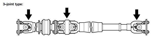

    oooo yeah. not doing yourself any favors here. Let me dig up the right diagram that describes the phasing.

    From the FSM:
    pay close attention to the zerk fittings and yokes. Once you have it in what you think it's the correct orientation, if you still get a vib, rotate the yoke 180 degress.

    That diagram is going to help a tone. Hopefully this solves the vibration thanksss!!!
