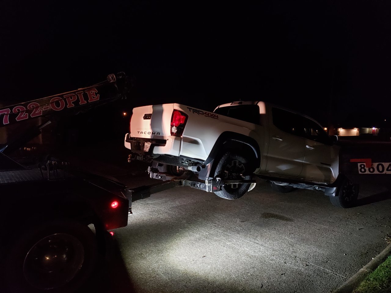

    I never noticed a brake vibration before all this started happening. After the dealership swapped out the cables though I did notice a vibration that felt like it was coming from the rear. I notice it when going downhill and using the brake to control my speed. Idk maybe it was there before and I just wasn't paying attention the way I am now. Not sure how that would explain this though.

    Interesting..
    I wonder if the problem is actually in the booster or an electrical connector related to it. The OR has a pretty fancy braking system after all, it can hold/modulate brake pressure at any wheel.
    I had a '16 OR M/T, and only once did I have an issue even remotely like this. I made the mistake of washing the truck in the winter and then not driving it very far before parking for the night. It took a few tries to get one of the rear wheels to release, but it wasn't too bad. Like my new truck, I always use the park brake (also a manual trans).
    Definitely want to see the outcome of this one.
    Good luck!

    To me, that looks like something beyond a parking brake sticking. I would agree with those above who questioned the ABS/TractionControl system malfunctioning. You would really have to yank a parking brake tight to get that kind of hold power. I wonder if someone was monitoring the ABS system if they could see that brake being applied? Is that functionality available in TIS? Maybe the water is causing issues with the wheel sensors reading properly?

    It sounds like the dealership is doing their best to figure out whats going on. They are in contact with one of the chief technicians at HQ or something like that (at least thats what I've been told) but don't really have a good idea of what is going on. They ran it through their car wash and parked it with the parking brake engaged overnight. This morning apparently it ran just fine. Classic.
    I contacted Toyota of America, not to complain, but just to have them involved and hopefully have a good outcome from all this.
    So no real updates yet but I'll let you guys know what ends up happening.
